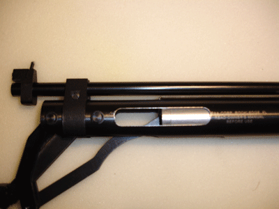

The only thing you should have to pay for is to change o-ring part 35, and that is if it ever a leak develops, never heard of one such case.
Getting the compression cylinder out is not for beginners, you need some torque applied to get that cylinder moving out of place, everything else is very easy to maintain.
http://www.airgunarena.com/index.php/Di ... structions
The reason I got the cylinder out was to do some weight reduction, but the best way to get some serious weight out would be to use airplane grade aluminum for parts 50/51/43 the pumping levers.
It is a great pistol, and I miss mine already.
IZH 46M
IZH 46M
