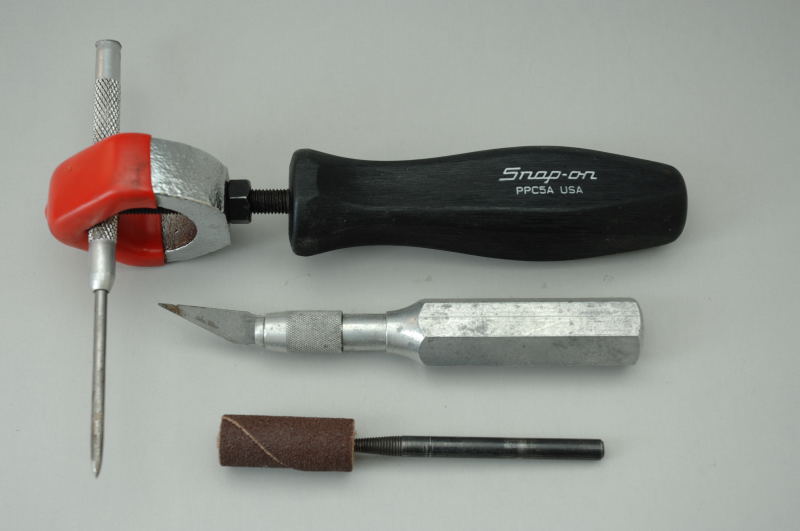

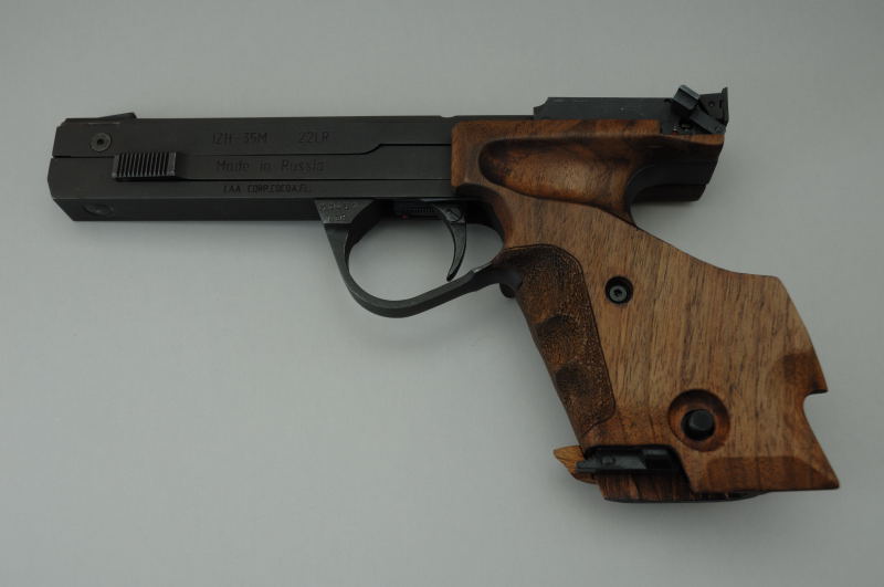

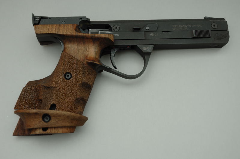

I did this, with this;

Very nice, but I have to think that the grip companies have a reciprocating machine that does that.

I don’t know how grip companies do it, nor how Rink operates but I have seen Hoffman at work. He did all the finishing by hand. The tool he used looked like a brush of nails that were fixed on a hammer to increase the impact. And that was it, the rest was craftsmanship. Btw, Tzed250 you did a nice job. It proofs that ‘the knack and how to do it’ is important.

I agree, nice job Tzed250. It would be interesting to see the top surface of the palm shelf. I presume it's flat but, for some reason, get the impression it might be dished.
