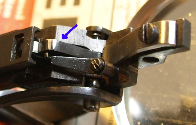

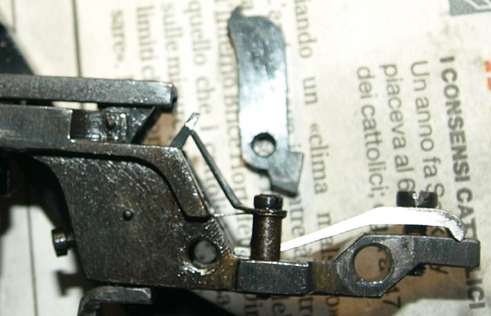

My Toz start 3 click 1 bang.
Firing pin doesn't be released.
During dismantling and clean, i missed the stecker spring... apart from that, trigger doesn't function: seems that lever doesn't travel far enough.

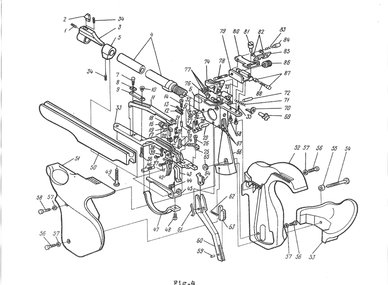

paulo
Posts: 338
Post by paulo »
Have you tried increasing pressure from the spring part 70 by bending it a bit, gently. It cured mine.

mjmarz
Posts: 60
Joined: Sun Jan 21, 2007 9:17 pm
Location: Saint Paul, Minnesota
Toz trigger malfunction
Post by mjmarz »
There have been previous posts which get into the resetting of the levers. During cleaning, if one moves the levers when the limiter isn't positioned, the levers may become out of synch. There is a stirrup and pin system which can become disengaged and needs to be reset. With the hammer out, the connection between the two levers can be checked easily.
