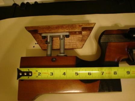

I would like to take a poll of the shortest possible length of pull set ups for all the different smallbore stock styles available. If you don't mind, please measure your stock from the front of the pistol grip to the rear of butt where the buttplate goes into the rifle. You can see the attached picture as to how to take the measurement.

some of the stocks like the precise have a movable pistol grip, , so, where do you want it fwd for small hands increases the length and back for big hands shortens the length

Well if folks don't mind it would be nice to know the distance with the pistol grip in the rear most position and the forward most position.

I have the Gemini ultra stock. The measurement from butt to front of pistol grip is 8 inches.

I have the anschütz 2213 alu.201mm min and 217mm max with a grip size med there is also a large available.

Measurements are from front of grip to rear face of butt plate carrier.
Anschutz Precise stock - 8 3/8" with medium size grip.
G&E stock - 8" with grip to the rear
8 3/4" with grip forward
Measured with the short Butt plate carrier ratchet and Medium size grip.
The long carrier ratchet adds 7/8".
The precise stock grip is not adjustable in the forward/rearward direction or for cant. It does move laterally and rotates.
The trigger reach dimension becomes long on the G&E with the grip fully to the rear, 1 1/16" from front of grip to front of trigger blade ( anschutz 5018 trigger with standard straight blade fully to the rear).
