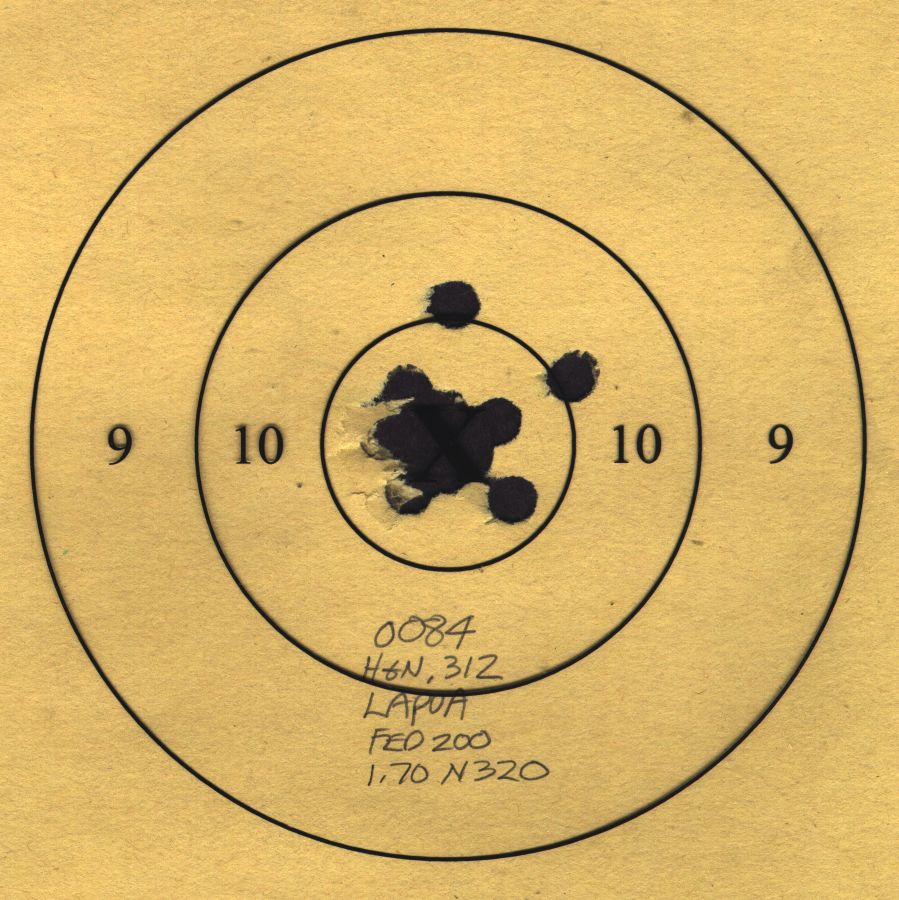

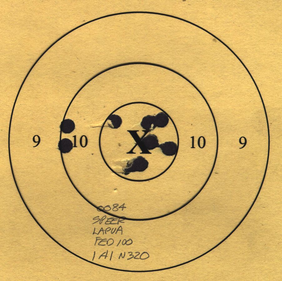

Greetings,
I test my barrels with 1.70 grains of VV N320 (three-twenty) with both Speer and H&N HBWC bullets. Expect velocity to be in the range of 725FPS.
Pardini HP with Wilson Custom fast twist  barrel. Fired at 50 yards. Ten shots.
