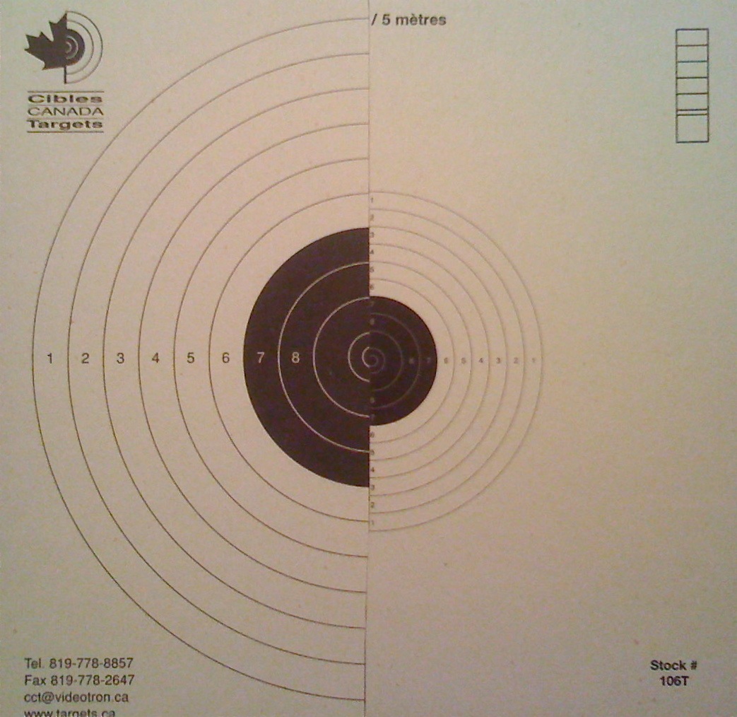

Post by SeaBlue52 »
I was able to order correctly-scaled five-meter targets from Nikkonos in Quebec via eBay (right half of the attached image). Nikkonos was great to deal with, and the targets were quite inexpensive. The paper quality is nothing like Edelmann or Kruger, but the targets worked fine.
For me, shooting at five meters is apparently easier than at ten, as I was able to post 5-meter scores consistently 15 to 20 points above my 60-shot average at ten meters. For this reason, I discontinued training at five meters, but if I had no other option, five meter training is better than no training.
Good luck in your search.
I used to buy 106T 5 meter targets from Cibles, but haven't been able to get them in a while.

@SeaBlue
As mentioned, the reason you are scoring higher is likely the fact that while the 5m target is 50% of the regulation target, the pellet is still the same size. So the pellet will cut a hole 2x as big as it should in the reduced range target, and what would have been a near miss will score the next higher ring.
This is why a lot of CF shooters used to use the 45ACP for the center fire portion of the 3 gun match. (.22, CF, 45ACP) A bigger hole means a near miss w a .32 could cut the higher ring with a .45
So the 5m scores are not directly comparable to 10m scores.

Gary,
The 5-meter target is smaller than half the size of the 10-meter target to adjust for the pellet consistently being 4.5 mm ... that aspect of the process is already accounted for. I understand the impact of shooting CF with a .45 vs a .32, but all ISSF air events are shot with 4.5 mm pellets (yes some are 4.49 or 4.51, but all are practically 4.5).
Seablue52

SB
OK I thought that the 5m was simply a 50% scaled reduction.
Glad to see that they accounted for the pellet size.
Is the BLACK bull the 7 ring, or is that 50% of the 10m target?
The bull should be scaled w/o adjustment for pellet size since that is a purely visual aiming point.
The black is, as in the 10-meter target, the seven ring. While not exactly half the size of the black in the 10-meter target, it appears to me essentially the same over the front sight. Since I have been trained to focus on the front sight and not to look at the target, any subtle differences simply do not register.
At five meters, the targets work well. I apparently just do better at that distance. Makes me wonder how tough it would be for me to shoot free pistol at 50 meters!!
