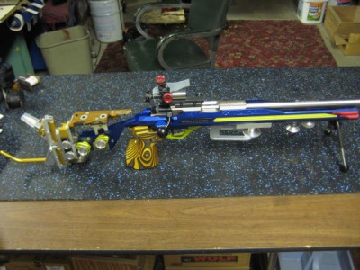

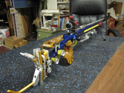

Not to interfer with your quire, Id love to see some pictures of your Anschutz/Grunig and Elmiger rifle......do you have some photos you can post ?

I'll take a couple of photos this week and post them.

Post by B&S »

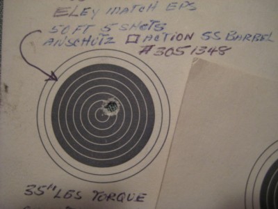

Pictures of the 2013 in a grunig stock. The torque to bring this gun into one hole groups with Eley EPS and Lapua Midus M was 35 inch LBS on all 4 screws

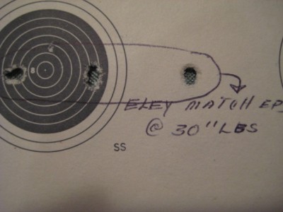

2 groups with above Rifle at 2 different torque settings

Post by B&S »
group at 35 in. lbs
