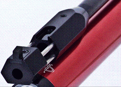

I think i have found a place in auz that is selling Blow-Out compensators. I am going to get one and put it on my toz. has any1 used one on a cm162 air pistol. If so do you think it makes the muzzle flip any better than with the factory compensator

I was also interrested by this compensator, after enquiry, I was told that they only have it for the CM84E.
Irosa compensator is available for a wide range of free pistols (CM84E, Hammerli, TOZ).

I'm assuming there is a .22 caliber model,as your picture shows a .177 AP example

Yes, but shooting Ronny Nilsson's comp (that's what it is on the pic above - bought a early model from him last year, he's a great guy!) is quite interesting - the gas is in fact pushing against the rear face of the front part, and it does make for a different feeling. Don't know if it's better, but at least it makes everybody else stare :-)

jsealc21 wrote:I'm assuming there is a .22 caliber model,as your picture shows a .177 AP example
Yeh its made for the cm162 and the cm84. I am going to modify the toz 35 to put one on so i can improve the accuracy. Just trying to find out the affect it has on the feel of the gun as to whether i buy it for the morini as I am more interested in the affect it would have as a muzzle break rather than a compensator. The gains it would have ove the morini compensator would be negligable
And only for those two pistols, answer I got from Interprodukter on my request for a Hammerli version.
There are of course two models: one for .177 (CM162) and one for .22 (CM84E)
