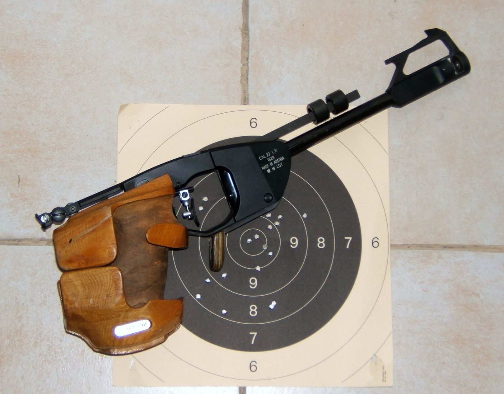

This is my "new" Steyr FP.
How common is this pistol among forum's members? need some info...

Also, I wanted to point out that the pictured grip does not look like anything I've ever seen on a Steyr before. It looks almost like a TOZ grip. I'm curious about that, as well, if anyone knows.

Look at the picture of the Steyr FP in the 10P Files. THAT'S the factory Steyr grip in walnut, and I have the factory grip in laminate, which is identically shaped. The grip pictured above is not that grip.

It has the Steyr Match badge on it, I'm sure they had a few different ones over the few years that they made it. I'd like to get one with the laminate grip.

The factory grips were laminated. As seen here:
http://www.schiesstreff.ch/images/dscn2062.jpg
The grip shown here has a very Russian style to it and I suspect it has been custom made by someone Russian or Russain trained.
It's quite easy to make a grip and transfer the Steyr badge over to it. I could be wrong but very confident that the grip is not Steyr original.

j-team wrote:The factory grips were laminated. As seen here:
http://www.schiesstreff.ch/images/dscn2062.jpg.
I think the factory grips were made by Karl Nill.
j-team wrote:The grip shown here has a very Russian style to it and I suspect it has been custom made by someone Russian or Russain trained.
You are completely right. I've got this grip from ex-national team member. The grip was made by a Russian named Dadonov (or something like that), and was originally made for Boris Kokorev.
Unfortunately, my palm is longer and slimmer than Kokorev's, and the stardust left by him gone over the years... ;-)
