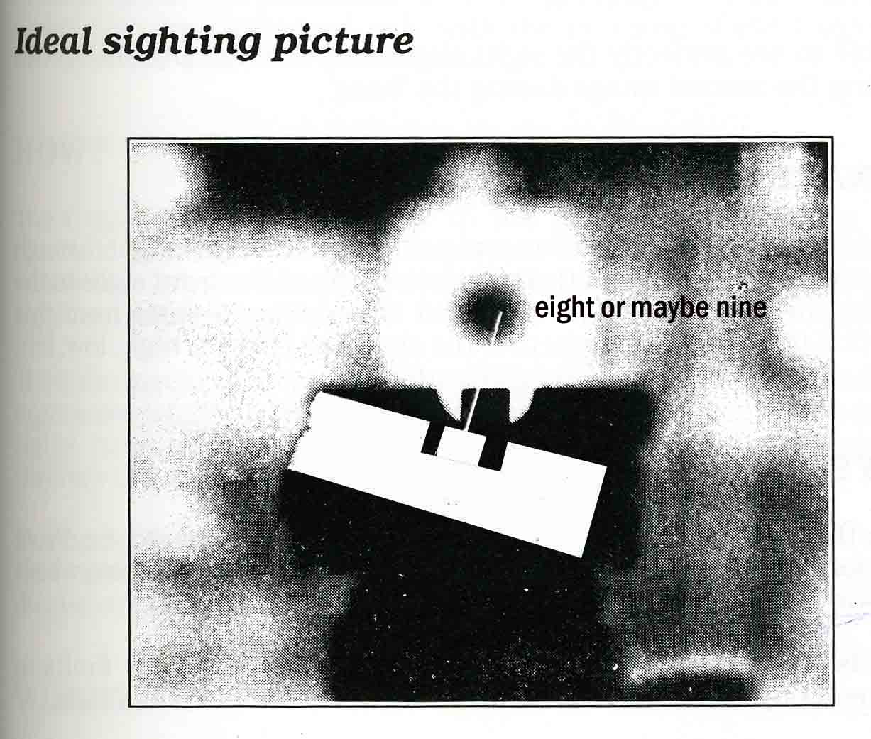

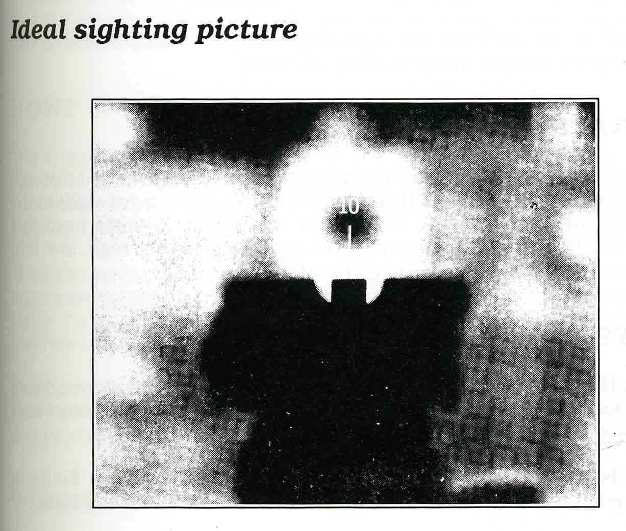

deadeyedick
Posts: 1198
Post by deadeyedick »
Canting will have no effect on POI if the shooter has his/her rifle/pistol sighted in on the point they wish to impact [point of aim], but does have a huge say in where the projectile lands depending on the amount of cant, and how low in the target the area aim is set to.
If a shooter has their sights set somewhere in the white, below the black, so the bullet passes through the 10 ring and was set that way by a person who shoots with a constant cant, or position, then the impact point will not change. However in the 20 odd years of coaching pistil shooters, I have not seen one that accurately repeats the cant. Now , with that being said, if the sights are at point of aim, as I said earlier, there will be virtually no discernible change in POI. However with the sights set to an area hold position, because of the arc effect produced by the sights being set to approx. six inches below the actual POI, then the necessity to keep the pistol in the SAME [preferably vertical] position becomes even greater.
That is why some shooters believe they shoot better with the sights in the point of aim position [ they do not repeat the shot execution exactly as before ]. The area hold has many virtues that are not being exploited by most, mainly because of this . In fact, the lower on the target the sights are set to impact the ten ring, then the more disasterous the miss will be unless the gun is fired in exactly the same orientation as previously.
deadeyedick
Posts: 1198
A picture is worth a thousand words
deadeyedick
Posts: 1198
Or maybe two
