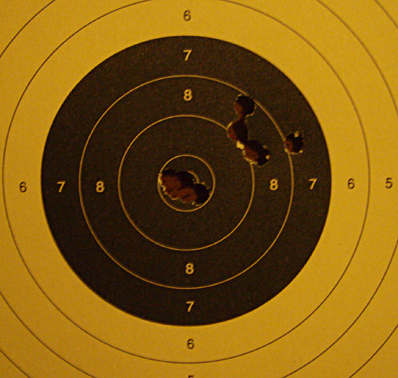

I have problem shooting AP, I shoot many shots in 2 o'clock. I am left handed shooter and I have read books trying to find out what happends when shot breaks. That problem is well documentet for right handed shooter but I havent found what that means for left handed shooter. Does anyone have any idea what would be the problem? I have picture attached about target.

Sorry, but the recommendations in this thread so far are complete copout.
There's a difference between mental and technical errors. The former causes high variance in results, while the latter is manifested as repeatable errors that share common traits. No amount of positive thinking will fix your errors in technique, and no amount of analysis of technique will make you mentally ready for a match.
Back to the topic:
The throws to the right for a left-handed person may be caused by (but not limited to) the following:
1) In your relaxed aiming the cant is at CCW angle to the vertical, i.e. the relaxed hold is a little "wrist-up". If you normally have to force yourself to keep the sights horizontal to prevent the cant, slight rotation of the wrist during the shot will put it to the right.
2) If you stand too sideways to the target , the NPA will drift to the right if you start slouching the left shoulder. As you keep aiming at the target, your whole arm may jerk in the direction of the NPA. This type of error mostly starts happening if you shoot with a heavy pistol and get tired. Also it is very easy to see when the rear sight moves during the shot release.
3) Pushing the trigger - this one is pretty obvious.
To further diagnose, shoot on the back of the target and see if the shots end up where you call them.

Now, THAT is a astute statement - because IMEx flyers inside/high are quite rare, except when I do something really strange, like pushing my shoulder somewhere else. And I think Steve is right, too - if you don't see THAT, you're either closing your eyes or doing something completely different in your stance.
I can tell how I deal with shooting AP
Today I shoot 5 times 60 shoot, 10 on each target. I never change the sight, very important! When the day is over I spread the targets out on the floor in the right order and sit in front of them and try to figure out a pattern. THEN I make changes and start fresh next day.
Do some warm up before starting, the first 10 shoot will be irregular.
See if you tend to move the hits during a match. Can be useful to know in a match.
See that if you had changed the sights by 2 clicks after third target you may had better results on the fourth target but less on the fifth and so on.
I think that how you handle the trigger is the most important and next how the grip is. Lift your head the same all the time and forget about where your feet are just as long as it feels right.

What's the problem
Before I assume too much, let me ask a question. Do you know when you have made the bad (out of group) shots without looking at the target? In other words, can you call your shot or know that it is not good at the moment of release?
If you can, then examine the differences in feel and technique between the bad and good shots. Then, concentrate on the making all your shots feel like the good ones in a positive way.
Avoid too much analysis. In fact, if you actually know that a shot will be bad just before or as it fires, learn to stop, put the pistol down, and start over.

What you as a shooter needs to do is really watch the sights and see which shots were technically great shots. Those that the gun doesn't move and you have great follow through in exactly the same place. When you get those you'll know. The other shots will be different for whatever reason, but the answer is to reproduce the good ones and dismiss the poor.
Rob.
The major problem with the wheel of misfortune is the major assumption it makes which is the shooter is aiming at the middle of the target. Which usually isn't the case.
As for the OP's problem the easiest place to start is probably on an electronic trainer. Then have the trace analyzed by someone wh knows what they are looking at. You can't tell what the problem is from looking at a target, the target basically only gives you a clue that something is most likely wrong.
I had a similar problem I'd have a nice group deep 9 and 10's then there would be another group in the 8 ring. Everything seemed fine, but under closer scrutiny I found that is was twisting at the waist. Stopped twisting at the waist and that problem went away (to be replaced by something else after all it is shooting).
