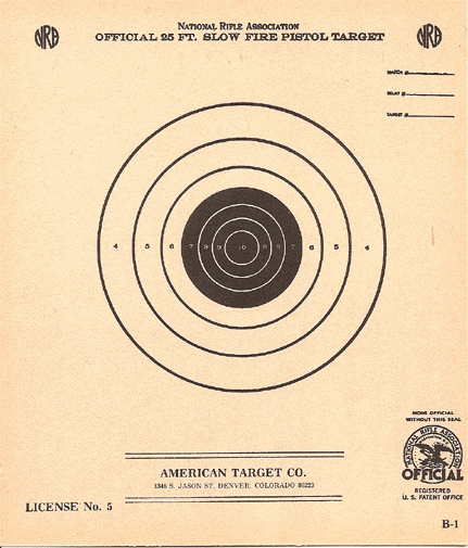

The B-1 target
Post by Jim Morrison »
If you don't have 33 feet and have close to 25 feet, try the B-1 or the TQ-9.
Attached is a gif of the B-1. It's a good one to start with. I have a copy of the TQ-9 after a while
Jim

If you want to find out the sight adjustment at close range, these two 25 foot targets may help.
Place the target, in the center of your pellet trap. Shoot 3 shot groups to get on the target.
After you get on the paper (target), again shoot 3 shot groups until all 3 shots touch or come close to touching.
Then adjust your sights one way or the other to move your group to the center.
