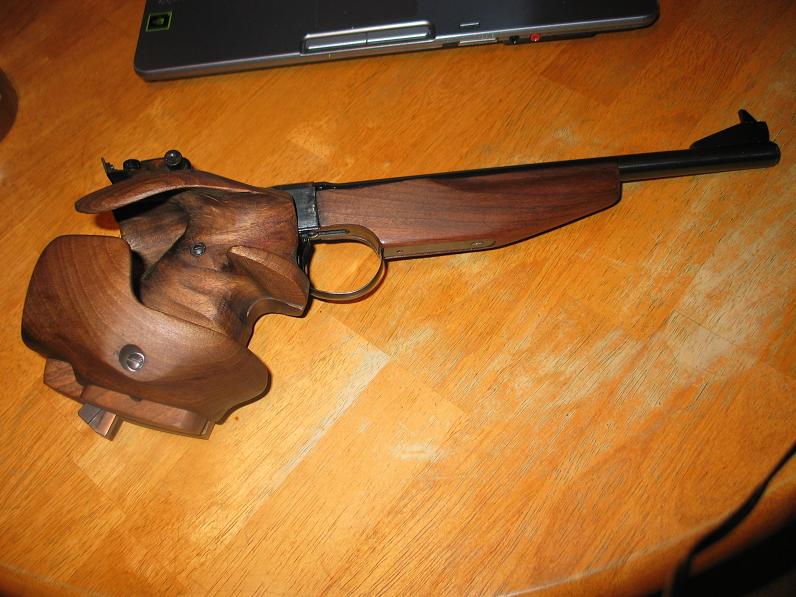

Problem solved!!
Post by Hugo »
Hi Guys,
Thanks a million! I found the screw, had to turn it about ten turns before the trigger snapped and then I was able to fine tune the whole thing. I just finished the work and the trigger works like a dream, all be it only able dry firing it for now. Coming Sunday I will test the new set up on the range, but it seems like it's gonna be fun.....
Hugo
By the way: gun wasn't only cheap, it still looks pretty as well!!
