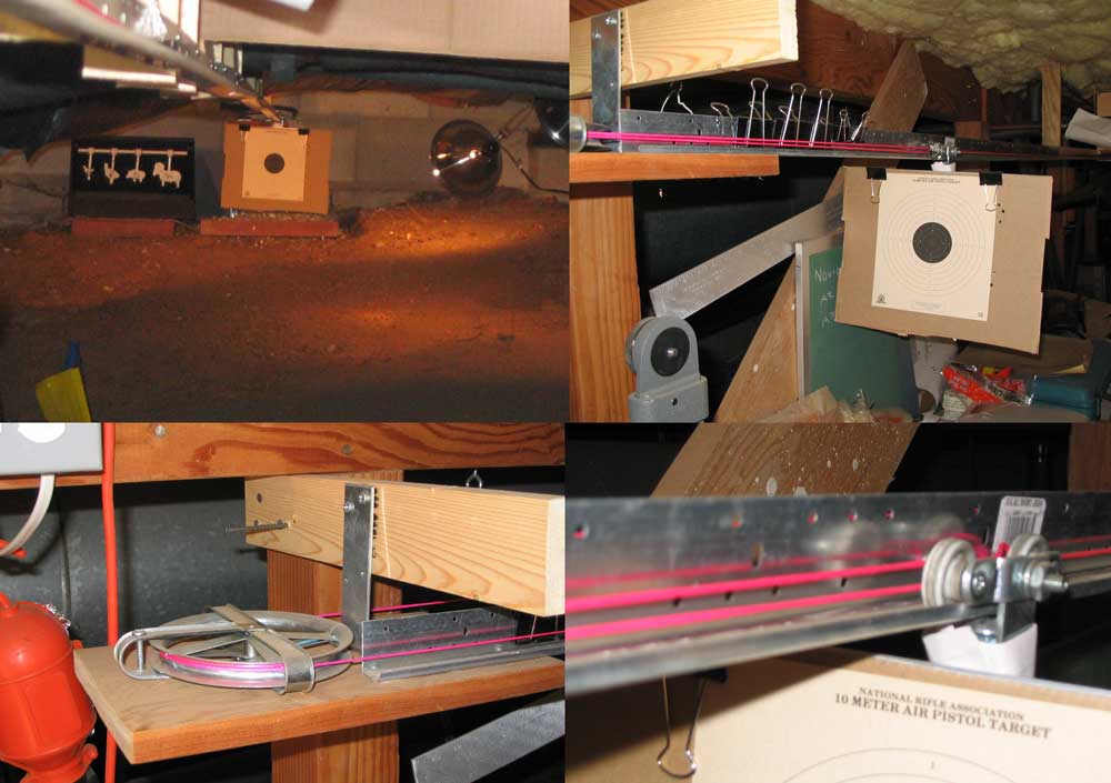

Post by GaryN »
depends how much vertical space you have. If you have enough vertical space, I recommend the one Pilkington sells. If you don't, like me, then you have to build one.
I shoot in my crawl space, and at the 10m mark I am literally crawling in the dirt. I had to build a track and pully system. Not elegant but it works. You have to be handy with home tools to make it. And there is a lot of jury-rigging to make stuff do what it was not meant to do.

If you are handy with home tools and hardware, go to a good hardware store and roam around. You might be able to cobble up something. The hard part is the pully. I used a clothesline pully, but the problem with that is...no handle, so I have to pull the cord.
If you don't use a track system, you need to have sufficient tension on the cord so the target will be held. If the target is suspended the tension is needed to keep the cord from dropping into the line of fire. If the target is held above the cord, the tension is needed to keep the target from flipping over.
Some times the time and effort to make something yourself is not worth it. It took me 4 weekends to make my tracked setup, and it is still not as good as the one that Pilkingtons sells. I need to rebuld one end and figure out how to put a handle on the pully.

For electric powered drives, you will need to rig a limit switch at the end, or the carrier will crash into the end stop. I thought about a low voltage motor, but decided that with a hand pulley I slow down cranking when I'm near the end, and I can feel when the carrier has reached the stop bolt at the end of the track.

GaryN
Posts: 637
Location: California
Re: Pulley System for Home Range
Post by GaryN »
BTW, this is my setup.
