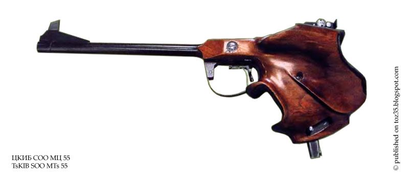

If you look more closely at that picture, you'll see that he is not holding a MTs 55-1. The curved cocking levers in front of the trigger guard are not there. What he shot the record with was a MTs 55 (no dash), the original version of the gun, with an underneath cocking lever, and presumably a very different balance. So I wouldn't draw any conclusions about the balance of the MTs 55-1 (or MTs 55-1M) from that picture.renzo wrote: If you google "Melentiev" you'll probably find an image of him with his record 1980 target in the background. If you compare closely the pistol proportions, yopu'll find (as I did) that the barrel of HIS GUN is approximately two inches shorter than the standard. Obviously, even him had his trouble with the long sight radius and the slender barrel.
The MTs 55 seems to be quite rare these days; I've only heard of one in the US. And BTW, there are at least 2 and maybe 3 different hammer configurations in the MTs 55-1, making replacement of this vulnerable part potentially difficult - don't ask me how I know.

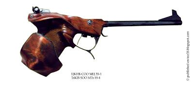

You're right about the Mts-55 with under the grip latch, but if you look to the accompanying photographs, you'll see that the barrel proportions and front sight ramp and post shapes are similar in both variants, and then very different than in Melentiev's, thus my (perphaps adventurous) conclusion.
The info I took was from a fellow (much older than me) FP shooter that visited the U.S.S.R. in 1980 for some sort of International Match I can't remember, probably a pre-Olympic event, and who brought with himself what was later to become MY MC-55-1.

Thanks for posting those pictures - I'd never seen a clear picture of the Mts 55 before. I wonder where the set trigger cocking lever is? I agree with you that Melentiev's barrel does not exactly match either standard model. The length is tricky to figure out, but the positioning of the front sight holder is definitely different.
Also looking at the familiar picture of Melentiev alongside the 2 pictures you posted another question comes to mind. If you look at the top front of the trigger guard in the Melentiev picture, it is contoured like the MTs 55-1 and not like the the MTs 55. Yet the MTs 55-1 cocking levers are clearly not there.
Maybe he really shot the record with a hybrid or a one-off special version, and not either of the standard models? How disappointing for us MTs 55-1 owners - we can no longer claim to be shooting the world record gun ;>)

Thanks for the additional pictures and information - very interesting! I'm sorry you don't have your MTs 55-1 anymore - it's always good to have an old friend around ;>)
I found another picture of Melentiev on Igor's blog, that perhaps shows the barrel to frame proportions a little better. It's on http://toz35.blogspot.com/search/label/free%20pistol about 1/4 of the way down the long page. From that picture, the barrel length looks about the same as the standard gun. Just thought you might want more data for your theory about it.

You're right, in that rare caption (I've never seen it before) it seems that he only modified the ramp and post attachments a little back from the muzzle, but somehow it doesn't seem the SAME outfit that is in the photo with the target in the background, maybe it was taken at other moment.
If you look carefully the caption of him shooting the pistol, he has long sideburns, in the other photo (the one with the record) he hasn't any.
Even more, it looks (maybe I'm mistaken) that in the act of shooting not only the barrel seems standard lenght, but also the rear sight is in the full backwards position. as you and I can recall, in this setting the rear sight lies almost on the back of the hand above the wood "ceiling" of the grip.
In the record photo, it would seem that the rear sight is in the forward position, resting practically over the knuckle of the index finger.
Obviously, we are discussing about the sex of the angels, as probably the only way to know for sure would be to talk to him in person about this. I tried to find him while making a long travel in Russia years ago to no avail, I'd given an arm for having a photo together!!!!
