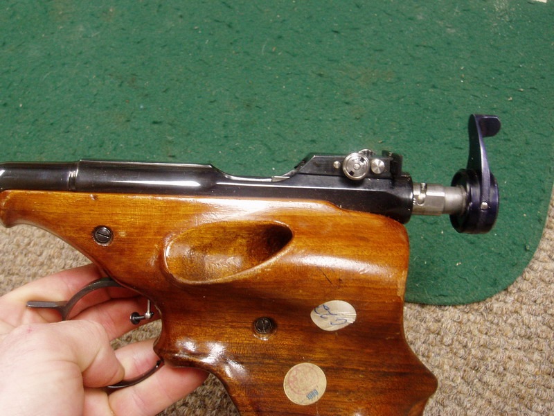

I bought a Vostok MC 2-3 free pistol. I don't know anything about Free Pistols and have some questions.
First, has anybody on this list any experience with this particular model. I tried the internet and the best was Potter firearms has a schematic on their web site. I had about 4 pages of the manual/diagrams and parts list that came with the gun and first thing I did was scan it and email to Potter Firearms. They will post it on their web site when they get some time to do it.
Now I tried to shoot the pistol and was in for a surprise. It wouldn't feed .22LR. The round doesn't go all the way in into the chamber. It this model chambered for .22 long/short?
I tried to feed a .22long cartridge and it seated in properly, hmmmmm. Locked the bolt, pushed the trigger guard down to engage the mechanism and TOUCHED the trigger. I heard the click but the gun didn’t go off. The cartridge didn’t even have a dent in the back. Did it again and again but no use. Could the firing pin be broken or am I doing something wrong here?

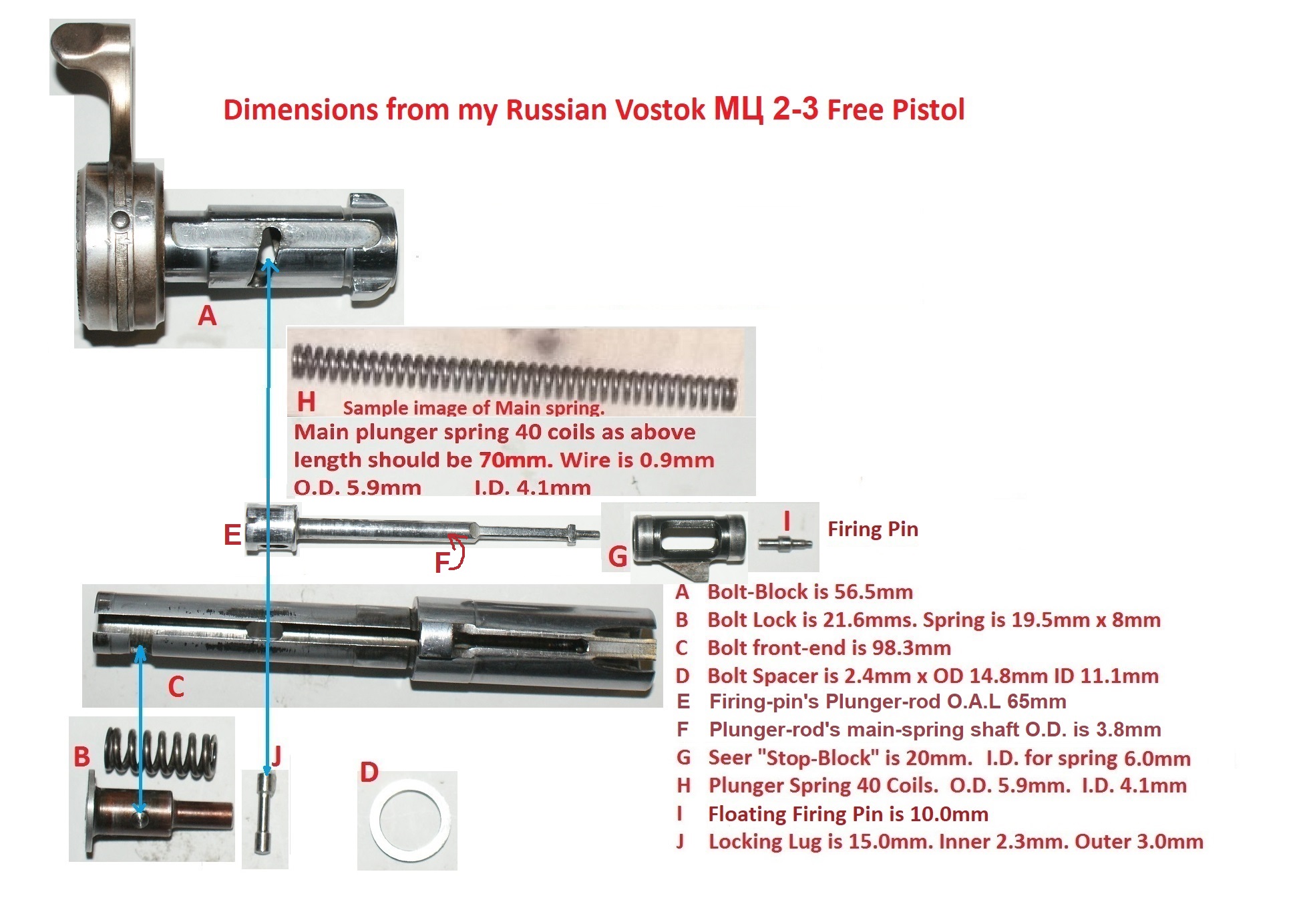

But the firing pin still doesn't make a dent on the rim. I guess I have to take it to a Gunsmith. Luckily it does have some spare in the box that came with it and I see some firing pin & other parts in thee too.

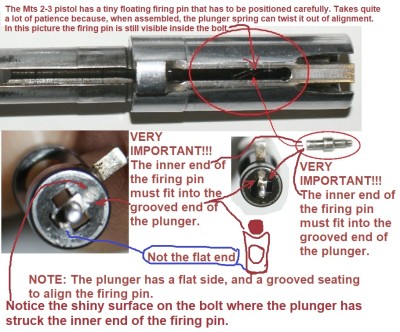

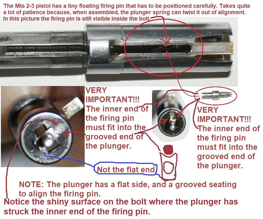

I agree that your feeding issue is probably a lead buildup for the same reasons stated by the others. As to the firing issue, I would look for a possible dry fire mode/switch (or an extra step to the cocking procedure). Is the bolt easily removable? If so, can you see the firing pin tip within its hole? How does it look? If it is broken, the break should be apparent. Next look for the method of actuating the pin. There may be a post within the frame that travels along a channel in the bolt. See if that post is movable by something. The post may even be directly linked to the trigger mechanism. What action moves the pin? If the pin itself is spring loaded and is released to travel forward, is there an obstruction, accidental or on purpose? If something else hits the pin, is the pin free to protrude from the recess?

Just spoke to my gunsmith. I was indeed a broken firing pin. He has fixed it and I will be picking up the bolt tonight.
