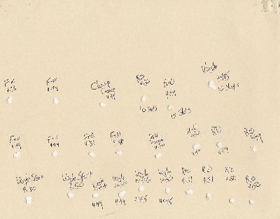

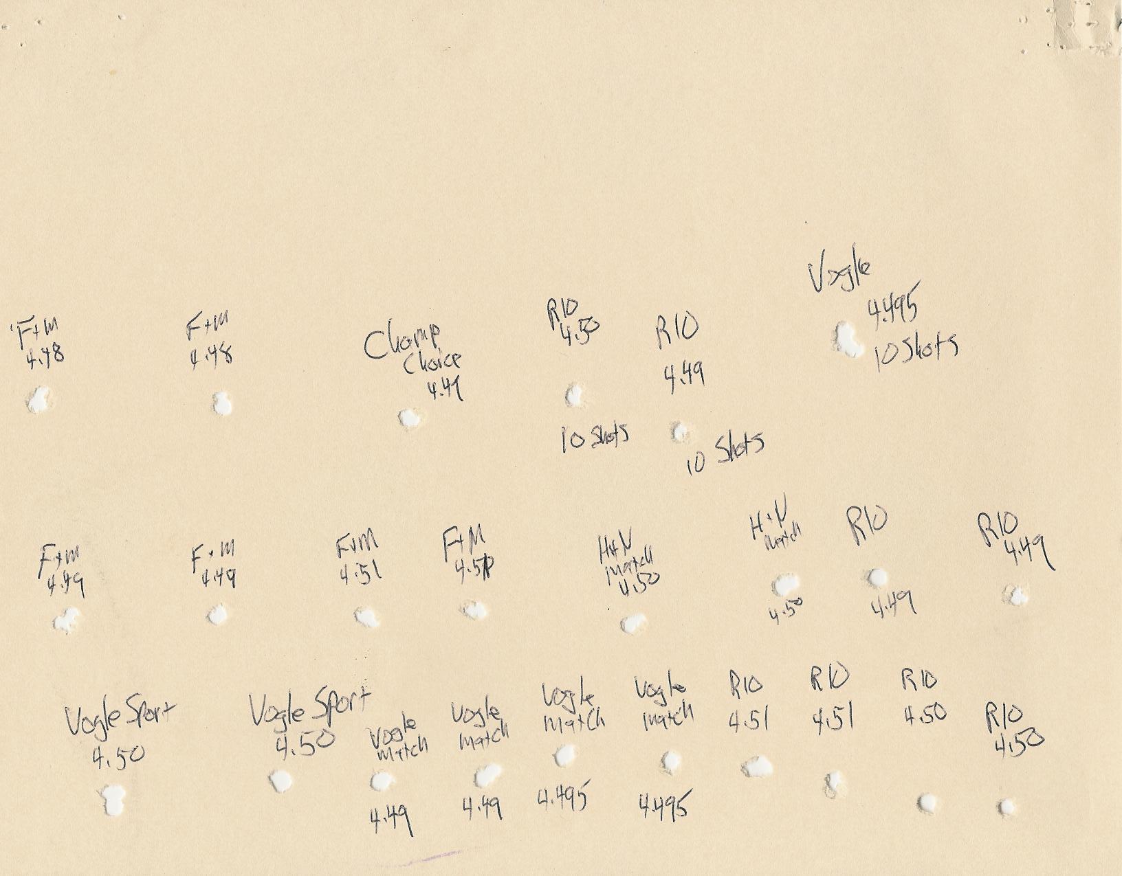

Durant,
Here's a test target I shot last year from one of my shooters Anschutz 2002CA's.
All groups are 5 shots except for the ones in the top row listed as 10 shots.
I used an Angie rest clamped to a Black and Decker Workmate. We've upgraded our range a bit and now have a steel platform we bolt to the floor, then the Angie rest is clamped to the steel platform.
