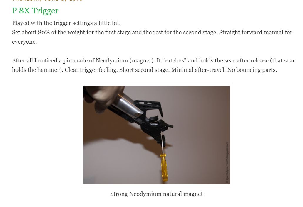

I wonder if the wondrous P8X trigger is partly due to the use of a magnet? - From Igor's Blog below -
