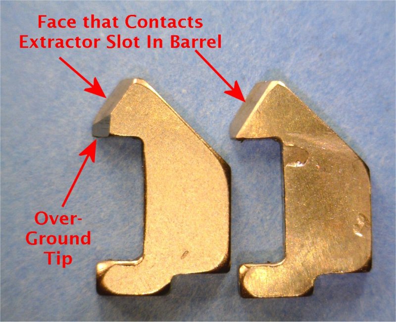

We've had a sudden rash of FTE's in 3 different Benellis. The symptom is that (typically) round 1 will only extract about 3/4 of the way, and then the extractor lets go and the bolt continues to the rear. It picks up round 2, which it jams into the case from round 1.
One most Benellis, the extractor gets pushed to the side slightly when the bolt closes. Ideally, as soon as the bolt begins to move reward, the extractor hook will pop back onto the case fully and you are fine. If the extractor gets dirty or the oil dries out, it can slow down or hang up, at which point the grip on the case becomes tenuous. The extractor spring may also be worn or compressed. Larry Carter actually had slightly stronger spring made up in the USA to help with extraction issues, but with his passing, it will be a while before those are available again.
I've been re-grinding the tips of the extractors to fix the geometry (see http://www.targettalk.org/viewtopic.php ... &#p274685) to hold the cases up into the bolt face. The problem I ran into is that if you have to remove a lot of material, the way I was doing it forces the extractor to the side even more when the bolt closes. You really need to grind it matching the sloping angle on the left front face. That matches the extractor slot in the barrel, and minimizes the deflection.
Here's a picture of an extreme case. I had to remove a LOT of material to get the tip angle right to hold a case securely on the bolt face. The one on the left is un-ground. When the front face is in contact with the extractor slot, the one on the left gets pushed a long way off the rim:

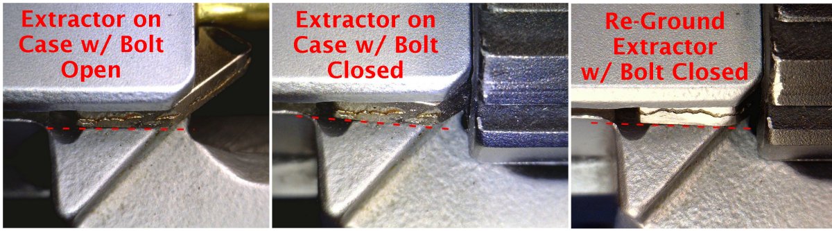

The picture below shows how much the extractor got pushed aside. When I re-ground the face, and not just the tip, things got much better:

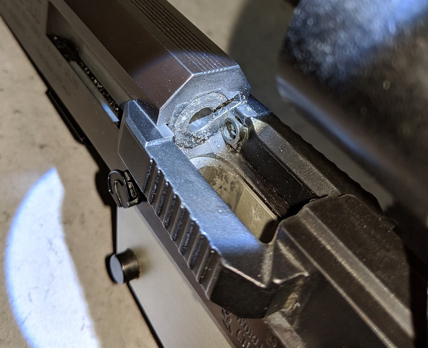

Ok, one more followup regarding the lead-and-wax-shaving behavior, or should I say non-behavior! Since this polishing, the pistol has practically stopped building up wax and lead below the chamber, and it cycles beautifully. There are about 400 rounds through it when this picture was taken, the last 300+ flawlessly. Happy, happy.
