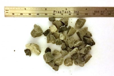

Both Bangsite and granular carbide are widely available on the web, at least in this country - eBay has quite a few offerings. The Bangsite, tho', is almost a powder and I'm not sure that would work with the SuperSmoker. It would probably load up the cotton wad that filters the gas upstream from the nozzle.
To give you an idea of the granule size, this I what I recently bought from RayVin:
