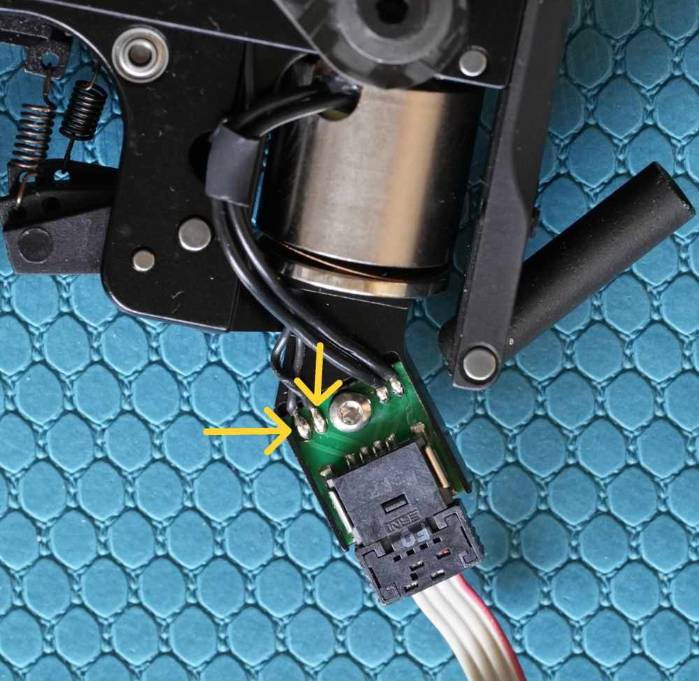

By this point I'd almost bet there is some issue with the trigger contact. There is something in there that prevents it from closing or the connector on the pistol side is bad. The trigger contact is closed by default and is opened when pressing the trigger. If it isn't closed during startup you get the exact described behavior (fast blinking).
Grippy
Posts: 119
Re: Morini 200EI doesn't want to work anymore
Post by Grippy »
I'd check if the two indicated contacts are connected with a continuity tester on a multimeter. They should be. If they are not the problem is inside the trigger mechanism/contact. Otherwise I'd check the corresponding pins in the connector, cable etc.
If it is in the trigger as an experiment I'd increase first stage travel (screw 1 figure 4 from the manual) and second stage weight (screw 2 figure 4).
