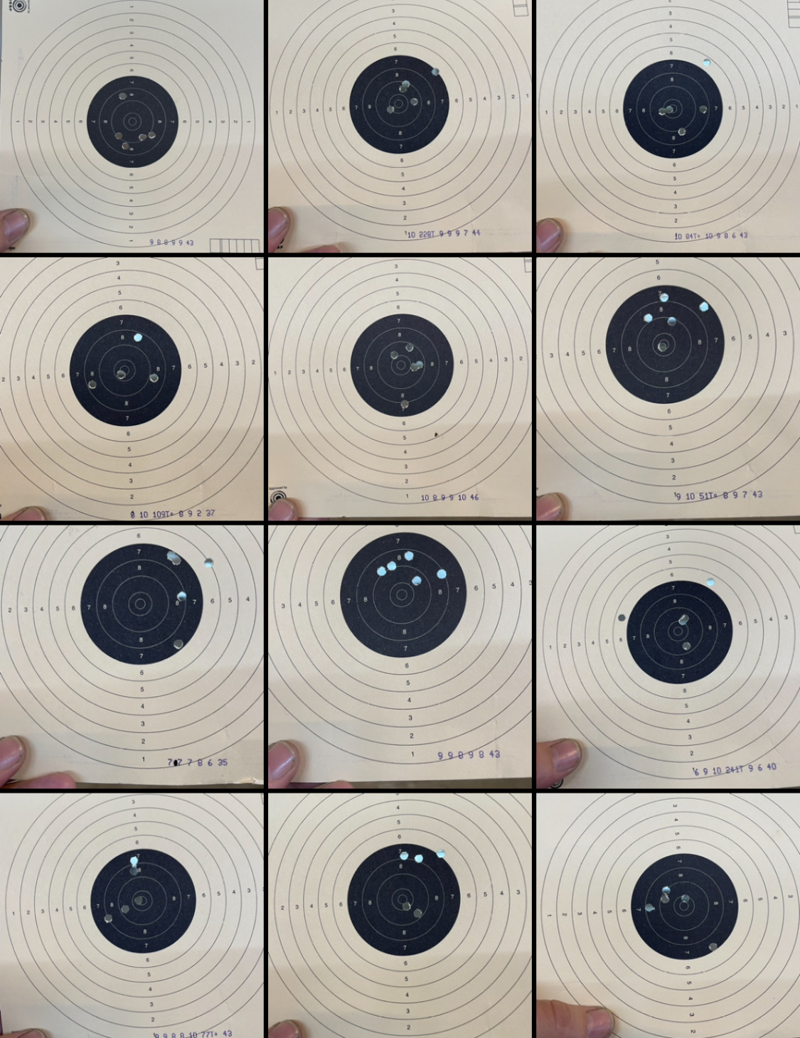

Gwhite wrote: Thu Feb 01, 2024 3:54 pm Stop worrying about the scores, and concentrate on identifying and fixing errors in your technique. The scores will come.
The shots out in the white have NOTHING to do with your pistol or pellets.
I know have nothing to do with my postol and pellets is my errors!!!
In the club rigth now i made 502 in a train match in 30 minutes! 5 shots per target 12 targets
43
44
43
37
46
43
35
42
40
43
42
42

As a quick guess, you are losing focus on your front sight. There is a natural tendency for the front of the pistol to drift up when you do that. That would explain all the high shots.
You may want to investigate shooting glasses. They don't have to be fancy. There are tons of postings on the subject.

Re: My Feinwerkbau P44+R10 Match+R10Match Plus
Let's make sure you have a good zero.
Put up two targets, one on top of the other.
Fire 30 shots, only changing the top target every 5.
Change your zero based on the 30 shot hole, ignoring the flyers.
Do it again and again and again.
Don't forget the vinho tinto.

Posts: 3569
Here's a good thread on proper sight picture:
https://www.targettalk.org/viewtopic.php?p=328047

I think what rover is saying is adjust to the center of your group, not to a few shots.
That will get you the most points and give you a truer zero. Remember if you throw a bad shot and you know why, don’t count it, but try to correct the cause. Good shooter learn to analyze the shoots.
Keep doing the two target trick your whole shooting career.
Things change as you mature.
All those shots to the right are YOU jerking the trigger.
Bailiff, whack his peepee!
Posts: 3569
Actually, if he's right handed, he's probably applying pressure with his thumb. All your life, you've practiced squeezing things between your thumb & forefinger. If you let your thumb get in the act when you squeeze the trigger, your targets will look just like that.
You do NOT need thumb pressure on the side of the grip to hold the pistol. Shooting a good group is all about consistency. The most consistent pressure you can apply with your thumb is ZERO. Get it off the grip, and those shots should evaporate.
If he's a lefty, it would be finger tip pressure.

Thank you! Im rigth handed! Most os tge outs i was not concentrate but i will take your advice! But wach this:
