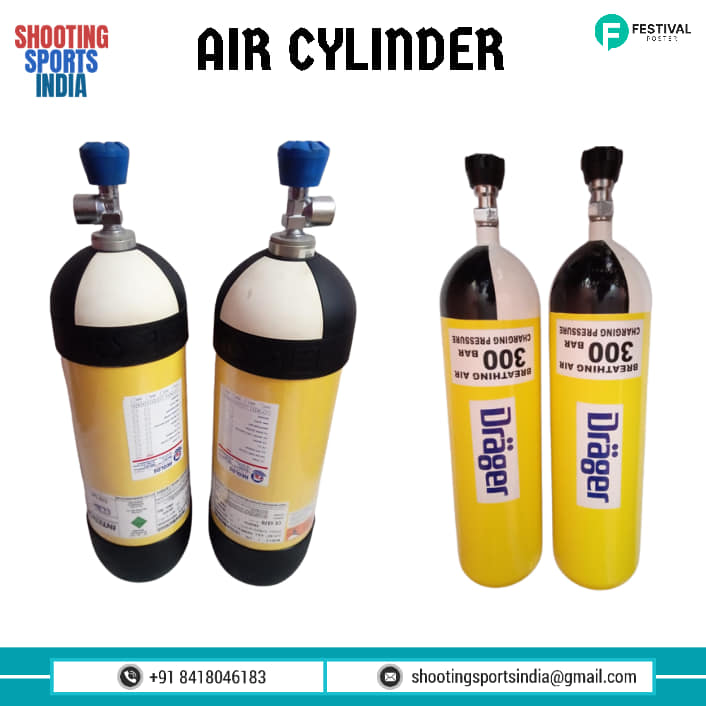

One of the scary things in India is the availibility of 300 bar bottles for refilling.
Too easy to overfill....
