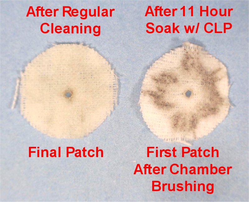

For those of you still in doubt, I did an experiment last night. I used a bronze chamber brush and a pull-through with patches to clean my MatchGun MG2, which had ~ 400 rounds through it since the last bath. I kept going until there was only a faint hint of fouling on the patches coming out. I saved the last patch, and then ran a patch wetted with FP10 CLP though the bore.
I let it sit overnight, used a clean chamber brush to scrub the chamber again, and pulled a patch through. Here are the results:
I think the vast majority of shooters would look at the first patch and conclude that their pistol was clean. For many years, I certainly would have. After the first patch this morning, it took another ~ 10 patches to get them back to what the last patch looked like last night.
The crud I removed after a good soak will slowly build up over years, and eventually can cause all sorts of malfunctions.
The secret is the soak. Even a few hours will help, but overnight is best. Beyond that, and I think the CLP evaporates enough that it's no longer working, and if you wait too long, the crud may re-solidify.
