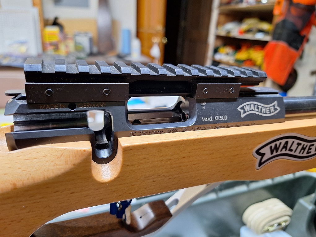

Carlos,
I ended up with an EGW rail. It probably will not set forward enough for prone mounting. Shells eject cleanly. It's also available in a 20 moa.
Good luck,
Gerry
Good luck,
Gerry

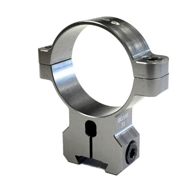

To Tim S: Most Bench Rest 50 and F-Class Rimfire shooters uses this KK500, that is why scope is needed. Most users just remove the upper alluminium receiver (which dovetail is about 11.55mm widht and 2mm height) and sets scope rings with dovetail attachement to the lower receiver (which dovetail is about 11.75mm and 2.60 mm height).
Like Gerry (thank you for your support) i have a competition scope (March 10-60*56) with picatinny Warne Mountain Tech rings than i swap between rifles. It is cheaper (and funny) to zero before competiton than have a expensive scope for every rifle.
About the standard clamp adapters (like the one tonyv138138 did buy at Amazon) it is designed to fit .0433 dovetails (11mm), so the picatinny axis is centered with the dovetail. BUT, i guess than if the dovetail is wider (like the KK500 on 11.55 or 11.75mm) the picatinny will have an OFFSET, because one side of the clamp is fixed, so the picatinny rail will not be centered with the dovetail one.
As i can see some competition products like Cicognani solves this with a special clamp (see photo below) with a central cut than will mantain centered both pieces. UTG Leapers has a riser with this system too.
Thank you all for your help.

Carlos, I did get your p.m. Actually the Amazon rail might work better as it must be slightly relieved underneath to sit atop a curved action rail. I had to file a small groove in the bottom of the EGW to allow the bolt stop some movement.

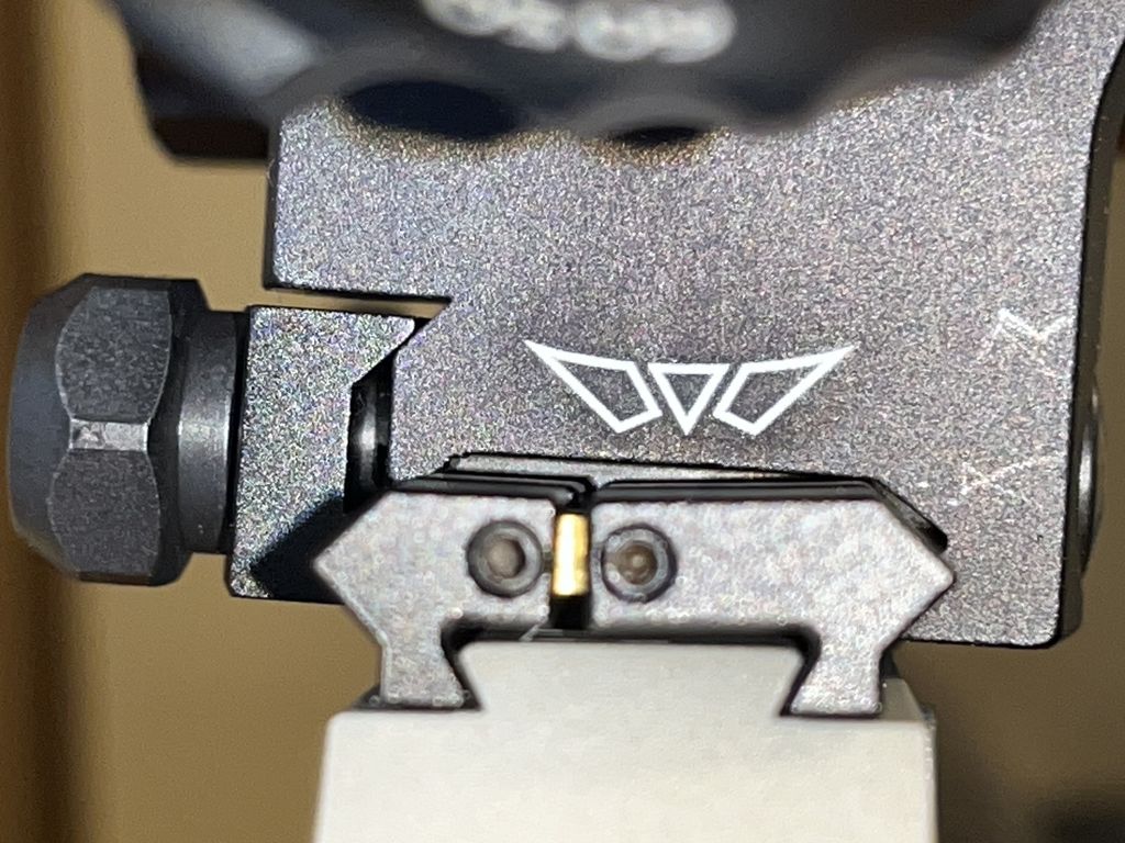

I also can highly recommend ADM Quick detach mount.
I was amazed at how little zeroing was necessary... sometimes none at all; and I always carry my scopes in a separate case to matches.
Gerry
Gerry
