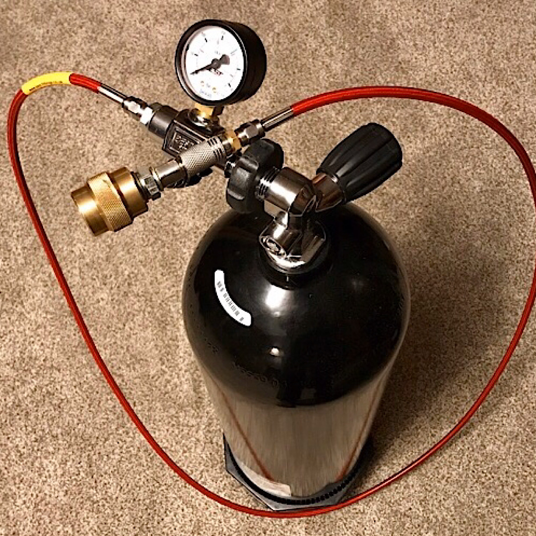

Air Supplies and Fittings
Hello-
If you do not want to look everywhere you could buy this tank from Champions Choice-
http://www.champchoice.com/store/Main.a ... s&item=S80
One does not need a pressure gauge, if they stick with a 3000 psi/ 200 bar tank. It can be nice to have, though. With a charging kit you can purge the air before removing the cylinders, reducing stress on the aluminum cylinder threads. The charging kit also makes it easy to switch between different adapters, for more functionality. Those items can be sourced from BEST fittings. A charging kit, and some quick coupling adapters will be needed, for ease of use.
Charging kit- (1/8 BSP)
https://www.bestfittings.co.uk/shop/air ... ton-bleed/
Quick coupler plug (QC) (1/8 BSP)
https://www.bestfittings.co.uk/shop/qui ... er-socket/
Adapter for quick coupler- (1/8 BSP)
https://www.bestfittings.co.uk/shop/qui ... pler-plug/
Female adapter-
https://www.bestfittings.co.uk/shop/fil ... -bsp-male/
The QC plug and adapter for the QC plug are not necessary, but nice to have. They allow one to switch out different filling adapters easily. If you do not get them the Female adapter will screw into the threads on the end of the charging kit hose. It will not be easy to remove, later, though.
All together, it ends up looking like the attached photo. (The hose in the photo is the 2000mm.)
Best regards,

Steel cylinders are also available in different working pressures. Older cylinders (and some specialty new cylinders) are rated from 2250 to 2400 psi. You can get high pressure steel cylinders in 80, 100, and 130 cubic foot capacities that are rated for use at 3500 psi. They are referred to in diving as HPxxx, where the xxx refers to the cf capacity. They typically cost about 3x what an aluminum cylinder does.
As a note on overfilling, the test pressure for scuba cylinders is 5/3 the operating pressure (hydrostatic test, DOT required every 5 years for any scuba cylinder that's going on a road or boat. It's generally voluntarily enforced by dive shops regardless.) The cylinder is filled with water, and pressurized well beyond it's normal pressure. Measurements are taken as to how much the cylinder expands. Too much and the cylinder is condemned. I mention this as a slight overfill of an air gun cylinder will probably not affect too much as long as it is not a standard practice.
The fiberglass or kevlar-wrapped cylinders you see for airgun/paintball applications are rated to 4500psi. I know nothing about recertification of these cylinders. I do know they used to have a limited life span - used to be you could hydro them once then toss them (that was before 2000.) I don't know if that's still true [note: I located one source that said a 15 year use span, so 2 hydro tests.) As an aside, I believe this style of cylinder is in use in Europe as a dive cylinder, but was never certified for use here (again, it's more a DOT thing than a dive industry thing.)
Scuba cylinders are generally either aluminum or steel.
Most aluminum cylinders have a working pressure of 3000psi. Some, though, are rated lower, in the 2400 psi range (generally older tanks, from 25+ years ago)

Re: Looking for a Match Pistol
I’ve settled on a SCUBA Tank for my air supply. It’s cheaper and safer than a 300 bar Carbon Fiber Tank. I now know exactly the fittings I will need and where to get them. Thank You.
My original question was “What gun to get?”. I narrowed the choice to a Feinwerkbau P8X or a Morini 162. Any opinions or experiences with either that can help guide me in making my choice? Reliability, adjustability and ease of service are important. I’m pretty sure either is more accurate than I ever will be.
