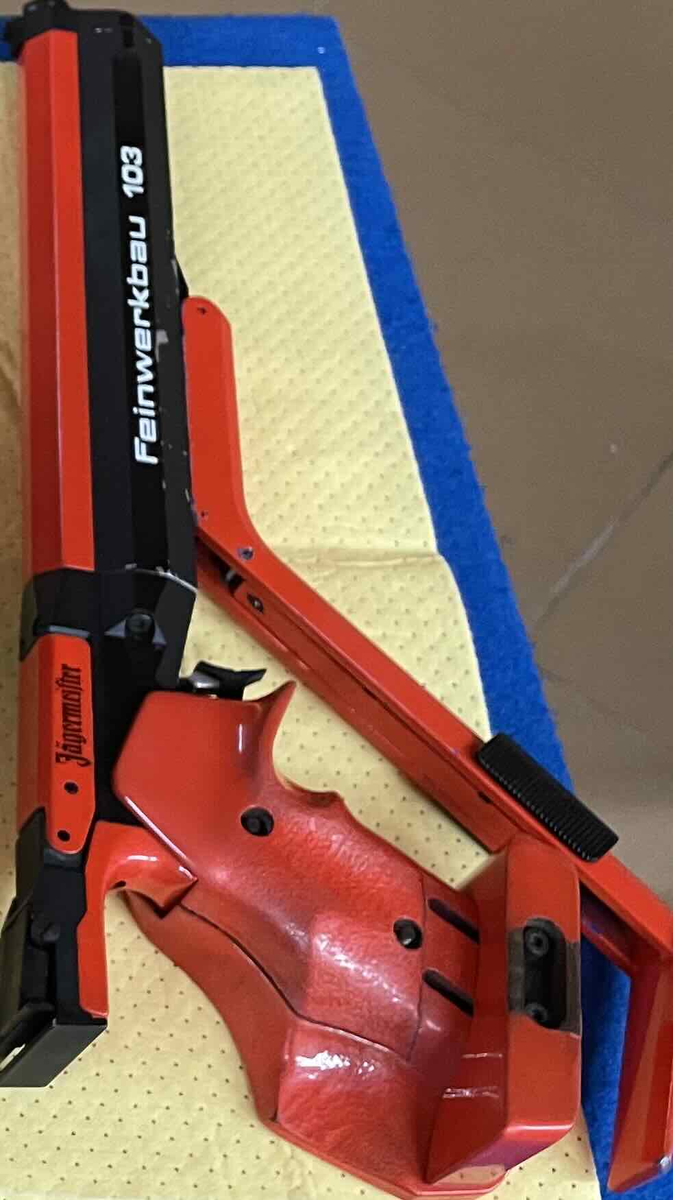

My Feirinkbau 103

My Feinwerkbau 103!
Ps-Sorry the name before was the text corrector
