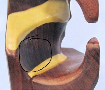

Here are a couple views of the grip with the existing putty. If you look closely, you will see the bump in the middle of the palm that i have ground down a bit in the past:
I could probably dispense with the little bit of putty down at the bottom near the palm shelf. My hand is apparently a tiny bit bigger than the original owner's, but the difference is so minor I don't feel a ridge from the putty. It's epoxy, and I'm not sure how easy it would be to chip off without chewing up the grip.

From my experience it is better and faster to start from scratch than to try to modify an existing grip with putty on it.

From your pictures you need to add putty at the back of the grip. See picture.
Use some cardboard shims to get a feel for how much and where you need to add.
Sand/scuff the areas where you need to apply the putty, so that it has something to adhere to.
Mask all areas that you do not want putty on. Masking tape works well.
Have a butter knife at hand to remove and adjust the putty while it's still pliable.
Don't add too much hardener so that you have some time to play with the putty. Too little and it won't cure.
Spread a little oil on your hand so that the putty doesn't stick to it. Just a little, you don't need to wet the hole hand.
Mix more than you'll need, apply to the grip, and set your hand in the position needed for the front sights to appear aligned.
Correct by sanding high pressure points, and adding putty to low pressure or void spots. Go slow, and add/remove as many times as it will need.
Don't try to do it all in one go. Work on one area at the time. As you get more experienced you'll get a better feel for this.
Finally, the grip on a free pistol is the most difficult grip to work on, it will take time, trial and some errors.
Once you correct your sight alignment, some other factor may come up, so do this after your free pistol season has ended.
Then, shoot with it a lot before entering in a competition. You'll have to "relearn" the grip. Your scores may drop a bit at first.
Good luck with it!
Hope this helps

Thanks! I'll stat by building that up with something temporary to verify that it is the right spot & to see how much I need. I'm guessing it won't take much.

I finally had a chance to play with the this last night. I put one layer of thin moleskin in the region indicated.rmca wrote:From my experience it is better and faster to start from scratch than to try to modify an existing grip with putty on it.
Good luck with it!
Hope this helps
Wow! The first go not only straightened out the sights, but it also eliminated the twisting I saw with varying grip pressure!
I will need to tweak things a bit before I make a permanent change, but it looks great so far. I will also need to either drop the heel rest or grind it out a bit to compensate for the added material on the left.
THANK YOU!
THANK YOU!
