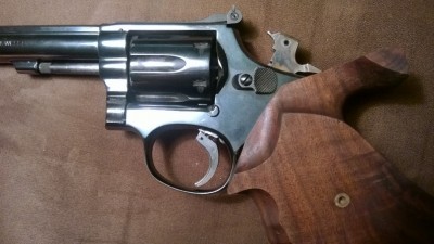

Bought the 14-2 seen in those pictures a couple of weeks ago.
S&W factory said this revolver was made in 1964, so it is oldest gun I have.
Someone had already cut the coil spring a bit to get to that 1,5kg sa trigger pull.
So I cut some more and now it is approx. 1,1kg. Good enough for now.
I have made a quick grip template to file and fill. Plan is to get it close and then copy-route the shape to walnut to make nicer grip.
Bought some 105 gr swc bullets to test that light loading.

My clubmate has a Manurhin 32 revolver with 2-stage trigger. Don´t know who added the first stage to that trigger, but it was not by factory.
I tested that revolver last summer and liked the trigger, so I started planning a modification to my 14-2.
I didn´t dare to try this with the original trigger, so bought another one - just in case mod does not work.
Dremeling, filing, silver soldering and drilling. Ready for test.
I need to find a stronger spring and -maybe- make less curved trigger blade.

Intriguing and very neat job. Congratulations it is much neater than the one I saw pictures of that was done in Oz. It had a spring tube run through the frame and a similar swinging trigger. We'll be interested in how it works out.

Are those grips Nil's or some other brand? My 14 needs a new handle and I'm on the fence between Nil and Fung grips
I have a set of Karl Nill's grip in my target S & W, but they only make them for ROUND BUTT FRAMES, which fortunately mine is.
Maybe you should ask Nill if they can carve them for square butts, or maybe go for it as is and file your frame...........................
Nill catalogs grips for S&W with square or round butt frames but they only show a left side profile picture of them. I was trying to figure out what the thumb shelf looks like and how big the horn is. I’d be shooting the pistol mainly in Bulls eye shooting events and I’m not sure I could thumb the hammer with a Nill ISSF grip.
