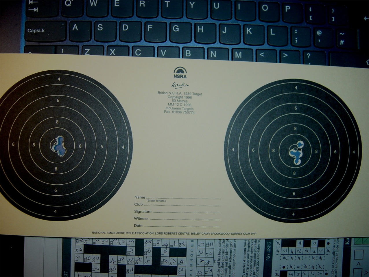

Re: Anschutz Modell 1411/1413 Match 54
Post by Gunter »
2nd attempt! - first disappeared again before I could finish my writings! what's going on?? - is there a time-limit??
re old Anschutz rifles: - an old thread, but perhaps this will answer the question of whether an old Anschutz
rifle can 'cut the mustard' as they say...
I attach a target shot yesterday at 50 meters
Anschutz (1410) 54 Super Match dated 1965 - wing safety
(Edit: as far as I know, it was the (very?) early 1960's barrels that were supposed to be better than later ones!?
something to do with quality of the steel used)
Headspace adjusted fairly tight!
Kenyon trigger at about 5oz - (Anschutz 5039 'set trigger' at something like 1 - 2oz gives a similar result)
BR50 stock (clone), bedded
action bolts set at 7Nm (according to old Karl Kenyon's instructions on his barrelled actions! (incl. Anschutz) - seems to work!)
original barrel! (must have had 250k rounds through it??)
Caldwell Rock Junior rest (adapted - see my earlier report on that)
NO rear rest! according to UK rules! - rest on hand.
SK .22 Flatnose Match ammo (which I use for practice targets)
(with Lapua CenterX I would have expected that '9' to be in the 10!)
not too bad! for a 73year old...
and for a 54year old rifle, for that matter! hehe!
best regards
Gunter

From one 73 year old to another, congratulations, Gunther, on those cards.
Just one question: why would 7Nm be advisable on what is, I take it, a wooden stock? I have not seen anything beyond 6 Nm recommended or practised even for aluminium stocks.
Gunter
Posts: 46
Joined: Sat Sep 15, 2018 8:56 am
Location: Rochester. Kent. U.K.
Post by Gunter »
No idea, really - just trying things out with my new Kenyon trigger!
Somewhere on this here interweb is a pic of a handwritten note by Karl Kenyon
advising his customer to tighten action bolts to about 60 inch/lbs - that is about 6.8 Nm
So I tried that (yes, laminated wood stock) and the groups seem to be smaller than on 5 or 6 NM
rgds
Gunter

For wood stock try 4,5-5 Nm
Y use this from 60's with Anschütz.
