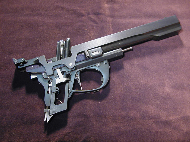

To my knowledge Roberto Palamà used a soft trigger stop (a spring inside) with his (at that time famous) Patro-M2 in 22LR.
You can see something here (look at the - moving - trigger stop): http://www.robertopalama.com/immagini/P ... tro_M2.jpg

visitor
Post by visitor »
Fascinating! Can anybody identify, give a short history of this one?
http://www.robertopalama.com/immagini/P ... _smont.jpg
