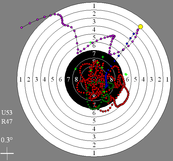

OK - here is an example of one of my traces (the worst example) but it amplifies the problem I have with 90% of my shots.
Green and Blue are default - 1s and o.3s before trigger

Based on what has alreadybeen duscussed, and your understanding of what the colored dots are showing, what do *you* think is going on?
I mean, it looks pretty clear to me . . . what do you actually see with your eyes as you break a shot like that, and what does the trace tell you?
Steve
Steve Swartz as Guest
Post by Steve Swartz as Guest »
Well, o.k. maybe I was being "too clever by half."
Actually you have two distinct issues going on . . .
1. Related to where the shot starts vs. where it lands; and
2. Related to the distance between the dots just before the shot breaks
They are related (common cause) but are typically treated separately.
Steve
(p.s. you have a ~580s hold by the way. I wouldn't worry too much about my "hold" or "wobble area" if I were you!)

I can tell when I have a 'sweet' shot (about 1 shot in 20) - it just feels right. The rest - well I can't call them yet - they certainly don't go where I thought they did (I've only had the AP in my hand on 8 occassions and shooting an average 60 shots with a .22 on average every second weekend for 7 months - I'm still a novice)
If I were to hazard a guess I would say I was jerking the trigger or squeezing the grip while triggering.
I also note that more often than not it accelerates away whilst I squeeze the trigger
Ed Hall
Posts: 236
Joined: Fri Mar 07, 2008 10:42 pm
Location: Adirondack Mtns
Post by Ed Hall »
I really hate to get into this long distance evaluation, especially when it involves highlighting errors, but IMNSHO, you have two distinct detractors:
1) Your pressures are not in line with the bore, and
2) You have poor follow-through
Suggested corrective actions:
1a) Find a grip that allows for a variation in tension to still maintain alignment. IOW, grip with as much of the force as you can being applied to the center of the front and center of the back of the grip, such that if you alternately tighten and release slightly, the sights stay aligned.
1b) Find a trigger finger placement and movement such that it keeps the sights aligned throughout, with a relatively fast (determined) manipulation. A slow actuation will allow you to cover up out of line trigger pressures by adjusting your sights with the wrist. A faster operation will show you when you have reached the optimum in trigger purity.
2) Stay on sight alignment for a definite moment after the shot. An outside observer should not be able to tell when you fired by your actions at that moment. This will move the purple part of the trace into the red hold area.
BTW, I agree with Steve that you have a great hold!

One other comment / question, is how long are you holding on for ? If you were to shoot 1 or 2 seconds earlier, you may well get in the region where your hold is centering on. It looks a little bit like you're looking for the perfect sight picture and almost trying to force it into the middle, with a resulting pushing of the shot outside the black. A simple thing to do is time yourself from coming into aim until shot release - it should be about 3-5 secs ish.
As above though, online coaching/problem identification and resolution is extremely difficult.

1. You are waiting for perfect sight picture before initiating the shot
2. You are disrupting the sight alignment when you apply pressure to the trigger
1. Can't be solved- you have to intuitively come to realize that you have to turn over control of the shot to some other mechanism than "wait until I see a perfect shot, then start to release it"
2. Dry fire against a neutral surface until you can reliably and confidently release the trigger smoothly and rapidly without disturbing the sight alignment OR the smooth settled wobble you have established. Mixed random live/dry fire will also help.
The good news is both problems are probably teh most common errors/bad habits developing shooters (of whatever level) will struggle with.
The bad news they are popular errors for a reason . . .
Steve

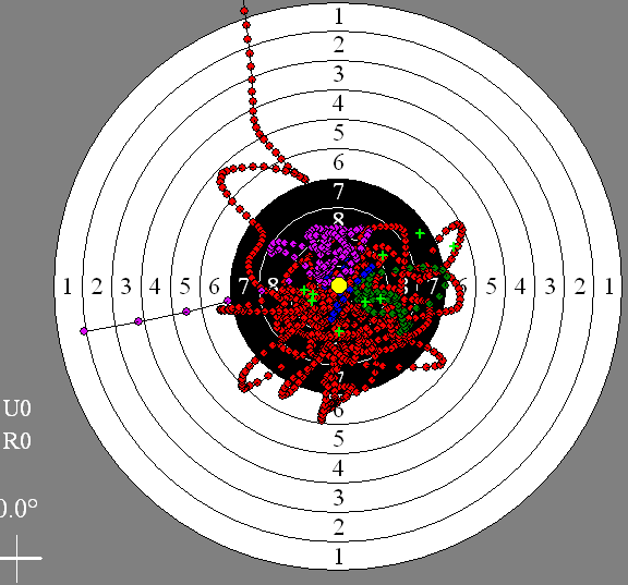

higginsdj
Posts: 199
Joined: Fri Oct 10, 2008 6:21 pm
Location: Canberra, Australia
Post by higginsdj »
I assume this is the 'ideal'!
