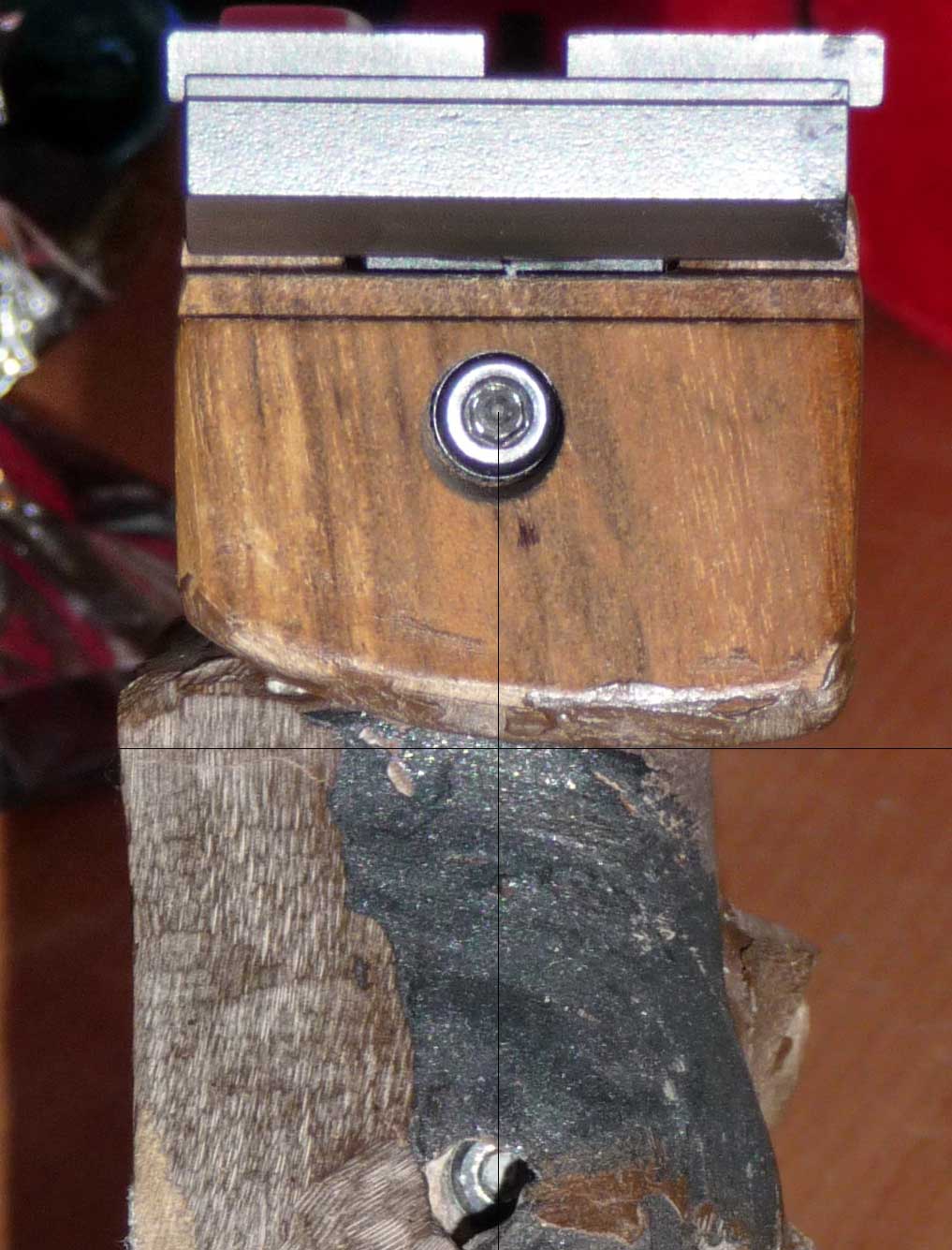

It's verry importand to look at the midle axis of the pistol. This you can see at a laminated wood grip verry easy. I have add the picture with two lines and you can see verry easy that this grip agree with the rules.
If you put your thumb at the left or at the right part of the horn, you can see it better. Otherwise it will be a optical illusion.
It is possible that some older pictures at our homepage are not meet the rules. Since the changing of the rules with the new pictures, we keep an eye on each grip for it.
By the way: The new pictures in the ISSF rules are made from us. If you compare our logo with the grip from the side you will notice it.
Best regards
Thomas Rink

I am sorry but if you take the vertical line you have drawn as being the "Griffachse" then it is clear that there is a part 6 or 7 laminations to the right that is lower than at the "Griffachse". That makes it less than 90 degrees and NOT therefore in accordance with the rules.
It all depends on the exact position of the "Griffachse". Unfortunately the ISSF rules do not tell us how to determine this.

That's the problem! Where you have to set the vertical axis?
You can use the axis of the grip or you can use the axis of pistol. That's not the same!
At the picture with the three red laminated grips you can see it:
At the left grip it's no problem, grip and pistol axis are the same. At this pistol you can't turn the grip in the vertical axis.
At the middle and the right picture the grip is turned about 3 degrees clockwise. So the right part of the horn isn't, relative to the rear sight, correct. But relative to the vertical grip axis it is okay.
But what's about the palm rest? If you turn the grip counterclockwise, the palm rest goes upwards at the right side. This is also not correct.
So you must look to the axis of the grip! Otherwise you can't use the possibility of some pistols to turn the grip angle.
You see, it's a difficult problem. But the easiest way to remove it, is to sand the right edge a little bit round and nobody can get on s.o.s nerves.
Best regards
Thomas Rink
