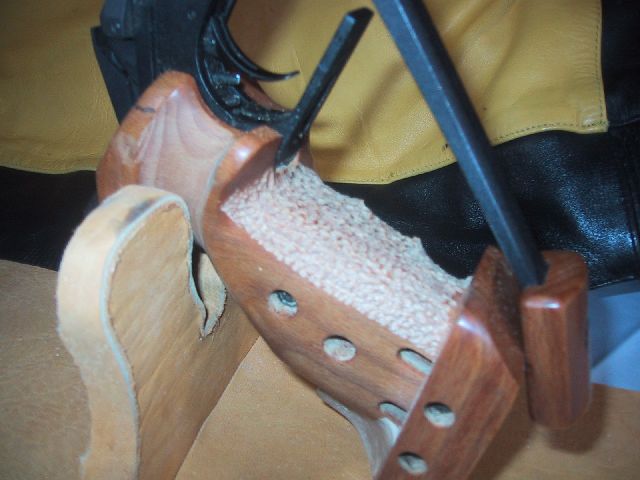

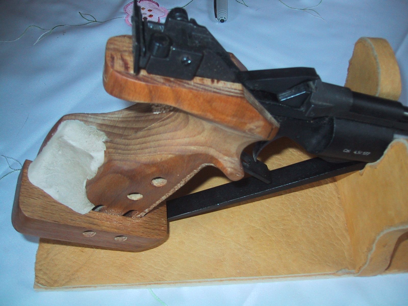

I must agree on the use of quickwood. It ws very simple to use with excellent results for me. I used it mainly on the back of the grip to fill in hole on under the base of my thumb. Quick and easy to use. Then I used the dremel with the small ball file to get a bunch tiny divets in the grip. I think both worked great.
scout18

Post by scout18 »
here are a couple of pictures of my grip
