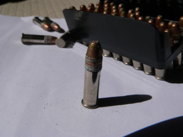

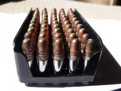

This box of high vel, jacqueted ammo is nearly 25 yrs old. Some time ago I found this last one in the back of a drawer. About 5 yrs ago tried some on an old .22 Marlin: did not fit the chamber.
Sorry for dark pix. blame picasa and its idiossincrasies...
P1050523 [640x480].JPG (52.32 KiB) Viewed 6424 times
toznerd
Post by toznerd »
That is a different animal. Those are copperplated bullets with corrosion; specifically showing the presence of corrosive salts. The salts have changed the outside dimension of the bullet. Plated bullets are generally not required to be lubed for their applicable velocity levels. Wax based lubed tend to lose efficiency at higher velocities, where molybdenum lubes can be effective into slightly higher velocities ranges. Of course, a wax lube can delay surface corrosion on the bullet, if nothing else.

Post by jacques b gros »
toznerd wrote:That is a different animal. Those are copperplated bullets with corrosion; specifically showing the presence of corrosive salts. The salts have changed the outside dimension of the bullet. Plated bullets are generally not required to be lubed for their applicable velocity levels. Wax based lubed tend to lose efficiency at higher velocities, where molybdenum lubes can be effective into slightly higher velocities ranges. Of course, a wax lube can delay surface corrosion on the bullet, if nothing else.
toznerd
Tks for the information. I had figured that two different metals like these two made a bad couple when pressed together.
