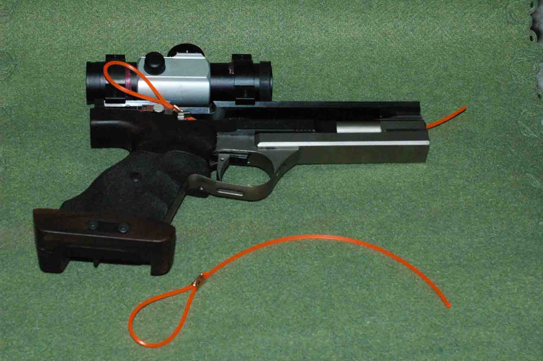

I saw this at my home club last weekend and thought I would share:
Materials list:
* .095 " weed-eater line cut to 12 to 16 inch length (longer for free
pistols)
* Fired 22 cal hull
How to:
Cut off primer end of 22 case (or drill it out if you prefer)
Thread line through about 3 to 4"
Pass free short end of line back through case to make a loop
Crush case to secure the lines together
Voila!! Almost free ECI...
Try it, you'll like it.

Now I understand, Tillman!
One picture. . . . .

Clever.
Is weed-wacker line typically biodegradable? I've been using it as an ECI and noticed that it becomes tacky from handling - but it may just be the type that I'm using.

Looks like a great idea, but I always wondered if that kind of line would melt in a hot bore. Has anyone ever seen evidence of this?

The melting point of nylon weed whacker line is 374º F - I think that under regular match conditions it would not melt.
Now, if you are, for some reason, shooting .50 cal BMG at a high rate of fire (say 300 rounds per minute) and the barrel starts to glow red, one should not depend on weed whacker line as an ECI. Ditto any Mini-gun...

Thanks for the tip.
Made one and it works well and looks nice...nicer than the weed whacker line with a tape flag on the end.

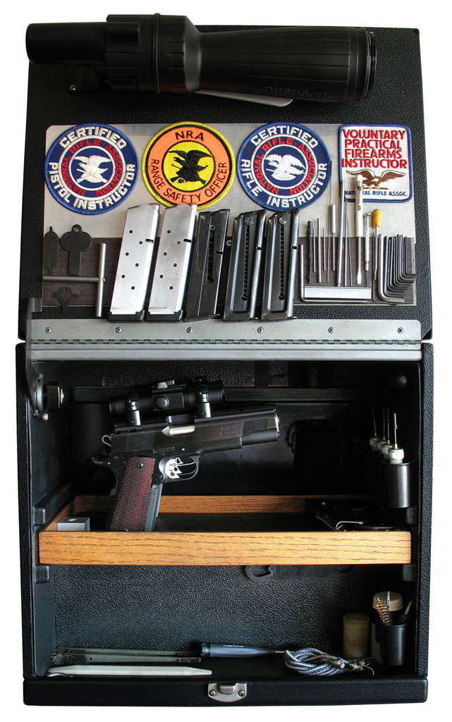

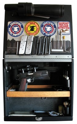

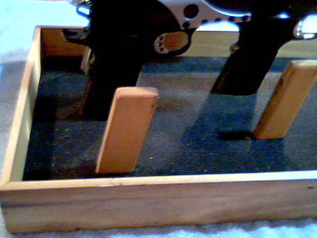

This whole thing of using ECIs and muzzle direction has become a real hot topic in a few forums. Here are my experiences. #1 A close friend and shooter had a Marvel in his box and another shooter asked to see it to show another individual a Marvel. When the gun was removed from the box, it had one in " the pipe", and the gun was in the box muzzle back across the line,,,not good. #2 another close friend and shooter calls me after getting home from the range only to open his box and find a 45, hammer back and one " in the pipe". Says he was scared that he drove home like that and was amazed that vibration did not set off the gun. Point here is WE ALL ARE MISTAKE PRONE!! Many of us including myself have never had an AD of any form,,,,but there is ALWAYS that possibility. The pics show the insert that I made very simply for my gun boxes, and I have two different trays made to accomodate different pistols. The cost to me to do this was about $15 and took me 2 or 3 hours. Notice all my guns will point downrange when stowed away. Three things I do and ALWAYS do. #1 I use ECIs when pistols are out to be shot. #2 I keep all my pistols pointed downrange when in the box,,,no exceptions. #3 I put a "snapcap" in the chamber and pull the trigger before the gun is stowed away in the box. That way I know that I know that I know that the pistol can NOT go BANG. PERSONALLY I HAVE HEARD IT ALL WITH THIS TOPIC LATELY,,,LIKE WE HAVE DONE IT THIS WAY FOR 35 YEARS, WHAT'S THE PROBLEM. I TELL YOU WHAT I DO FIND TO BE THE PROBLEM, and that is the general ASSUMPTION that all shooters are " safe". Or that I could not POSSIBLY make a mistake. How far back in time do you have to travel to find your last mistake???? Could it not happen with a firearm??? Good shooters would never intentionally cause harm with a firearm, but MISTAKES happen unplanned!! Safety is all of our responsability and we should help the other guy be safe too. Just a thought here, I bet we have all been on a line somewhere and saw a shooter " getting away " with something behind the cover of a box. Do you know and fully trust everyone on that line with your life??????? I seem to find that it's a different crew of nig nogs out there today. So I am choosing to lead by example in hopes that it may keep me a tad safer. I use an ECI when I am home alone shooting AP and I go " downrange" to change out targets.

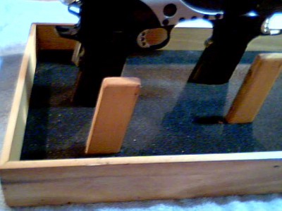

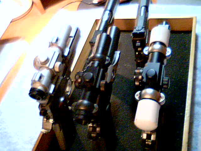

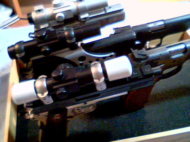

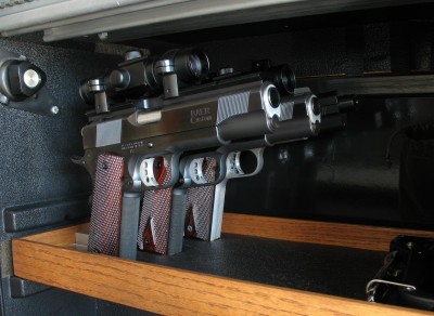

Slingers posting prompted me to show these pictures of another gun box tray set up so that all of the firearms are pointed down range in a safe manner.
If required, a fourth pistol (revolver) could be placed in this tray by laying the pistol (revolver) on its side with the muzzle facing the same direction as the pistols on the grip posts.

Pacymayr 5-gun box with original tray removed and replaced with a Red Oak insert for three pistols. Two more pistols could be fit onto the tray with different grip post configurations however the overall weight of the box could become quite cumbersome.
