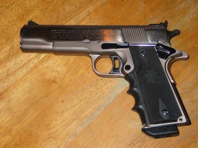

FYI: I posted a picture of the Gold Cup I bought a month ago, pretty nice I think. It included a .22 set along with it!
