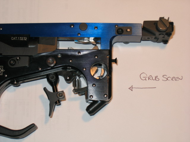

Brian
I had the "hammer falling" problem with mine. The secondary release lever (part 2059) engagement with the release lever (part 2044) proved to be too fine. Part 2059 is long piece which heads down into the grip area. You can see the engagement in the circular opening in the photo.
Engagement depth seems to be adjusted with grub screw (incorrectly labelled 205 in my manual)
Cheers Pete

I solved the hammer-fall on my MG2E by adjusting the small screw between the two rearward slide cover - holding screws. OTOH, three years ago the same symptom on the MG2 (M) was connected to the sear engagement first, and the grip angle second, so I wouldn't say that the same symptom was caused by the same problem...

Hi Brian
I'll ask my gunsmith what he did to fix the hammer fall but he did mention the levers I pointed out. Tycho has addressed the engagement within the strap.

Another one could be the triggerstop - I just remembered - when I got the first MG2, I adjusted the triggerstop far in, so I could "pull through" like I was used to from my 607, but that gave me a machine pistol...
