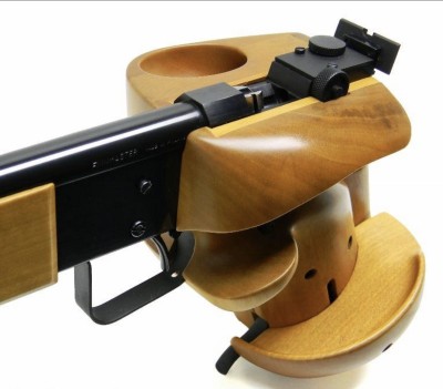

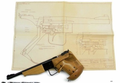

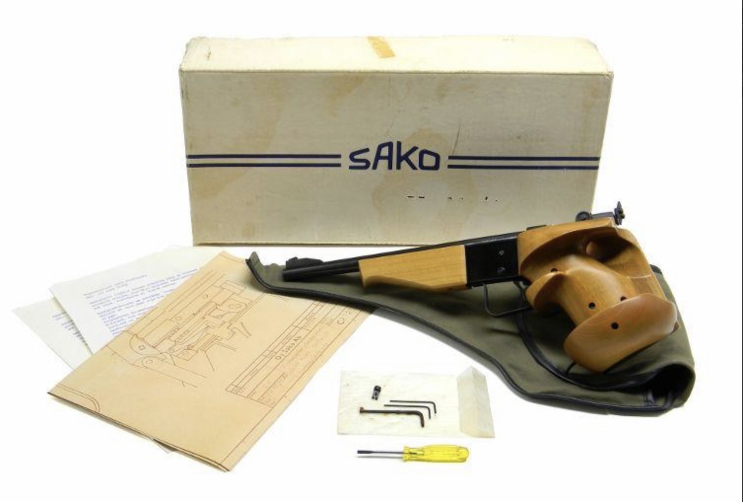

I remember the Sako Finnmster!
I saw one for sale with a dealer in New Orleans or Alabama. Serial number #180.
It was dead mint with quite a package of goodies. And, it was left handed, a plus for me!
It was also $4,000, so I passed.
But I saved some pictures and attached them here.
Maybe this helps a little bit?

Since the original posting, the info has been that the first series had SNs 1-60 (approx), the second series 100 or 101 to about 180 or 181. The pictures indicate an English translation of the Finnish adjustment instructions also were included with the one offered. As
I did list my set of 2 on the Sako collector's website, but at a lower price per gun than the one pictured. May need to rethink that.
As best I could learn, the difference in versions was in the internal firing and chambering/locking mechanisms.

The images posted appear to include an English translation of their Finnish info sheet, but so far, not available from SAKO.
In at least my translation of the Finnish info sheet, it primarily emphasizes the design features of the gun, including that the firing mechanism uses only one intermediate part between the hammer and the cartridge, while the other FPs of that time had an extended linkage. As a result, lock time and firing delay were very short. It also has brief operating instructions but unlike the Tri Ace manual, no substantial adjustment instructions. The Tri Ace manual is very detailed and precise in that regard.
