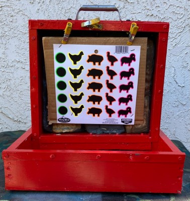

PeeWeeDaddy
Posts: 134
Location: Fairfield, CA
Re: Shooting Range Setup - Basement
Post by PeeWeeDaddy »
Take one piece of 1” x 4” x 8’ lumber.
Cut into 8 pieces 12” long.
Four for the sides and four for the back.
Paint.
Add a clip to hold your target.
Put in a few pounds of Duct Seal (electrical section of your hardware store).
Absolutely quiet.
After about 5000 shots discard (consider the environment) the duct seal, add new and start shooting again.
Note: The one pictured has an added area to catch pellets that bounce back..
Duct seal is expensive but the whole package is around $75.00
