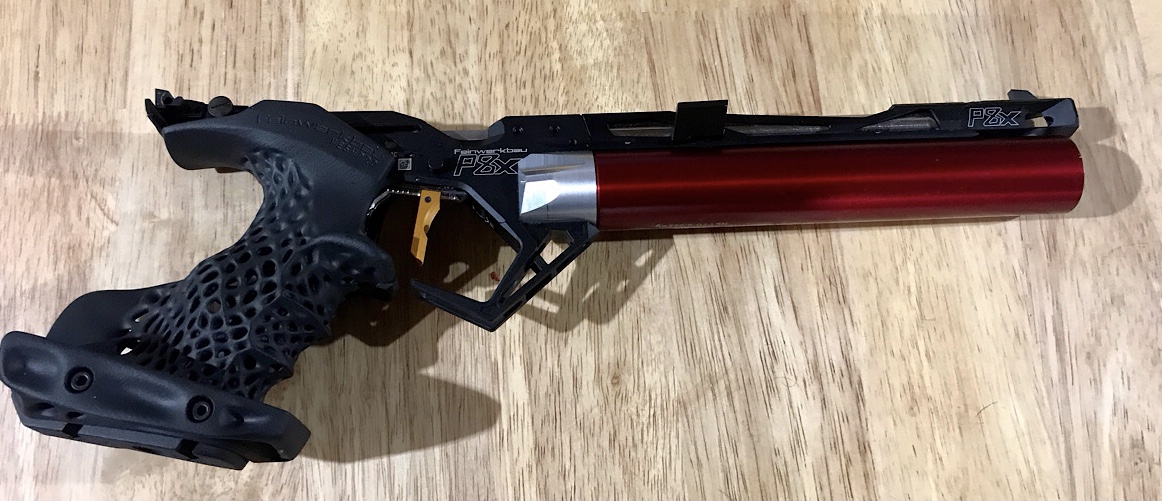

The Meshpro is an interesting take on air pistol grips. I am testing one now. Do I like it? Maybe. Less sweat during matches; it seems to aide wrist lock (for me). I have the Rink grip and the FWB grip for my p8X.... I need to make sure it is not simply a 'honeymoon' phase, for me...
I would suggest not spending any money on it, until you are sure you have grip problems that it might fix.
Shoot with what you have...unless you have the money to explore the alternatives- you will lose money trying, and discarding, different grips...folks will offer you about 1/2 of new, for a used grip in "pristine" condition- if anyone even wants to buy it.
Buying pellets with that money, and practicing, is a much better alternative.
