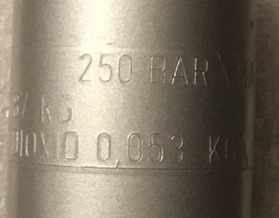

My Steyr CO2 cylinders have 250 bar ( 3626 psi ) stamped on them and that is why I don’t have pressure concerns using the 200 bar ( 2900 psi ) O2.

Posts: 3572
Re: CO2 to O2 conversion
deadeyedick wrote: Tue Nov 19, 2024 11:09 pm IMG_6022.jpeg
Thanks PJ and Doug.
That provides you with a nice big safety margin for CO2. Most of that will be gone if you try it as a PCP, and your cylinder is no spring chicken. Not worth the risk, IMHO.
The conversion kits will come with a nice new cylinder, fill adapter & the regulator. Considering what you get, they are very reasonably priced.
