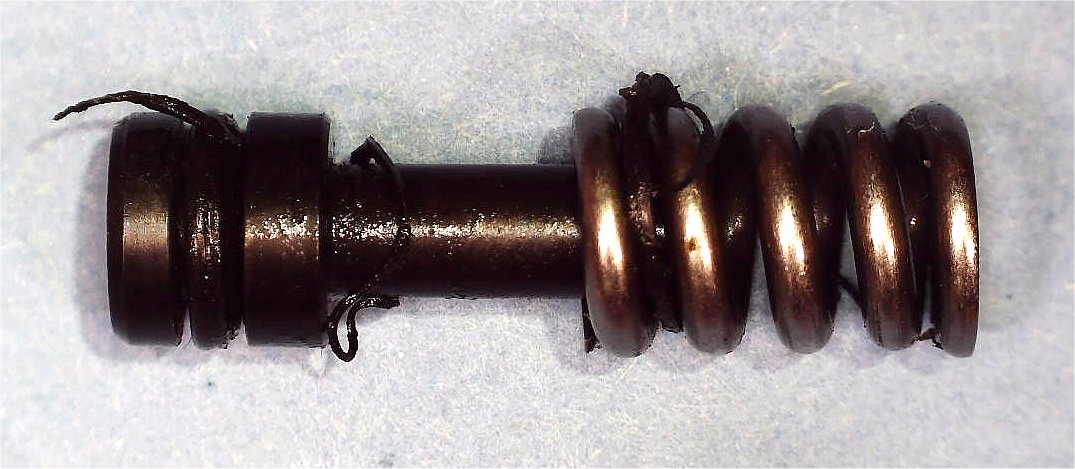

The problem is a special piston seal they use in the regulator. Instead of an O-ring, they use a "X-Ring", sometimes known as a Quad-Ring. These tend to shred:
Many of the repair parts for the pistol are used in other Hammerli/Walther air guns, and are still available, but not the piston seals. I suspect they ran out of spares a while go due to the high failure rate. I managed to buy a couple complete AP40 regulators, which included the required seals. I measured them, assuming they were going to be some exotic metric X-ring. I discovered they are bog standard "-007" sized ASTM/SAE X-Rings, available from McMaster Carr at $11.21/100.

We have several pistols that are in use by students, and appear to be working fine. I checked a couple with a chronograph. Both of them exhibited low (~ 400 fps) and erratic (+/- 10 fps) velocities. I brought them home, and took one apart last night. Sure enough, the X-ring was shredded. It's been re-sealed, and I'll do the second one today.
