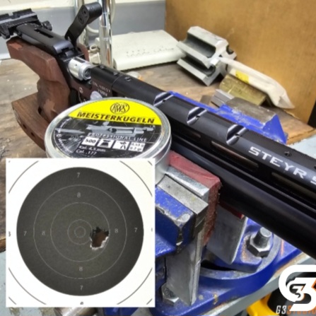

SPPcoach
Posts: 245
Location: Arizona
Re: Pellet testing
Post by SPPcoach »
This pellet testing may be habit forming.
Steyr EV0 10
RWS Meisterkugeln
10 meters
10-shot group
Bench vise
I have an athlete that is very reliable. Shoots in the 560 range. She recently started having occasional errant shots pulling her score down, and can't figure out why. My coaching philosophy is to blame the equipment until it is proven that it is not the equipment. Over the years I have seen equipment fail in many ways. I feel that this approach builds trust in the relationships between athletes and coaches.
So after practice this week, we put her Steyr in a vice and shot groups. Now there is clear evidence, not opinion, where the fault lies. It removes the emotion out of the conversation so that the effort can be focused on productive changes and not speculation. Now there hard work can happen.
Posts: 7050
Re: Pellet testing
Not to be nit-picky, but I've shot much smaller 30 shot groups with RWS Basic with an LP1.
SPPcoach
Posts: 245
Location: Arizona
Re: Pellet testing
Post by SPPcoach »
Rover, she was shooting at 10m, you were at 10cm. ;-)
