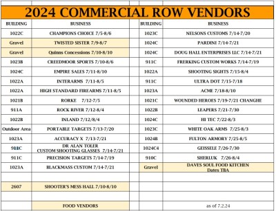

The CMP should post the list of vendors soon
https://thecmp.org/cmp-national-matches ... formation/
Scott Pilkington has been there the last couple of years for the junior rifle clinic.
Re: Camp Perry - Gun Smithing
Here's the link for 2024 Commercial Row
