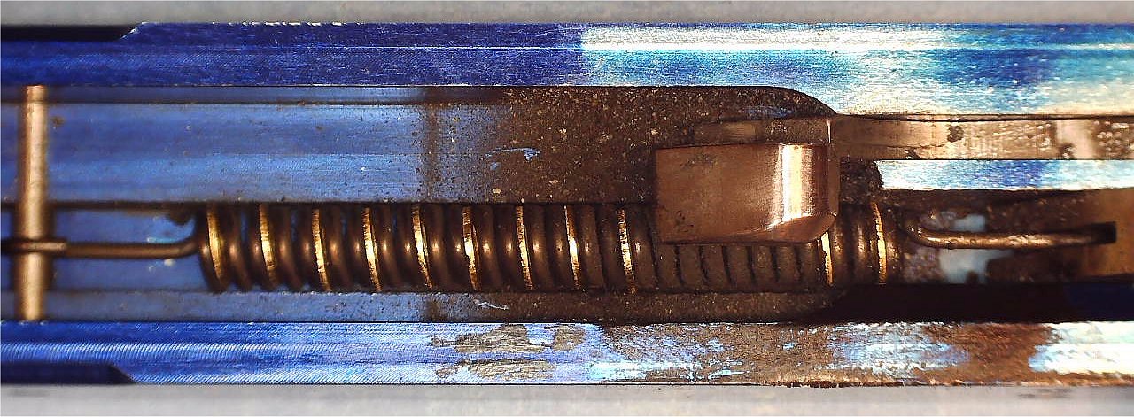

The springs can break. I've had to replace one once (with 3 pistols in service). There is a weak point introduced when the form the hooks, and I sent that info to the factory to see if they could get their spring maker to fix that, but I have no idea if they did that, or how many older springs are still out there in pistols.
Replacing it (or the "bullet insert lever" BIL) is a pain in the neck. I can dig up my notes, but won't be making a video until I have to go through the process again.
There are a couple things that make the process easier. The 3D printed bench block is essential. I also like these punches: https://www.amazon.com/gp/product/B0085V67VW.
The trick that really helps if the hammer spring is intact (like when replacing the BIL) or when you need to install a new one is to stretch the spring by inserting a bunch of small washers between the coils.

This what I used to relace the hammer spring (twice) on my MG2. Anchor the upper frame (I use an old Craftsman woodworking bench vice with wood inserts), partially remove the pin holding the spring in front, stretch the spring with the tool, push the pin back in to secure the front of the spring.
Designed for and works great on S&W revolver rebound springs.

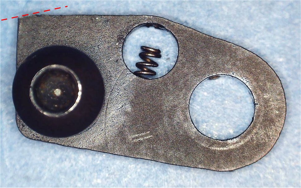

I've run into the slide lock problem as well. Some slides seem to sit lower than others, and can catch the edge of the lock. I put a slight bevel on the corner of the lock. That prevents it from snagging during cycling, but it still has plenty of engagement for manual operation.

Thanks Doug, I appreciate your feedback. May I ask what you used to bevel the slide lock and is it possible for you to add a photo of it so I can look at replicating it? Only if it isn't too much hassle of course.

Here's a picture:
I don't know why they would recommend against removing the carrier. If you do it a lot and don't take care to examine the set screw & replace it if it gets chewed up, you could eventually wreck the threads in the frame, which would be very bad. It's not a job for a lot of hamfisted gun owners, but if you are careful, I don't see the harm. The MG2 collects fouling faster than any pistol I've ever shot. Eventually, the fouling will build up to the point where it will cause malfunctions. You can flush it out with an aerosol gun cleaner, but then you have the problem of relubricating everything without getting oil everywhere.
I don't do it unless I have to, but I have had to quite a lot for a variety of reasons. I've probably had the carrier out of my main pistol at least a dozen times, and it has less than 10K rounds through it. All three of our pistols show no sign of any undo damage from the process. Total round count is probably close to 40K by now.

Thanks for the info and photo, Doug.
Does the set screw get damaged/chewed up from normal use of the firearm or is it purely due to removing and reinstalling the set screw to hold the pin in place that causes the damage?
Re: MatchGun MG2 Carrier Maintenance
The problem with the set screw is that the pivot pin for the carrier is free to rotate a bit. The groove that is ground into the left end is not a tight fit, so as the carrier operates, the pin rotates back & forth. The pin is hardened, and the factory makes no attempt to break the sharp edges on the pin. As a result, those edges dig into the screw threads and damage them.
Here's a photo of the screw that came out of my first MG2 when I removed the carrier for the first time:
What I have done since then is to stone down the sharp edges on the notch in the pin to reduce the damage. Here are before & after pictures of the pin:
When I've removed the carrier since then, the damage is minimal, but I still occasionally replace the set screw if it feels the least bit rough coming out. From an industrial supplier, a bag of 100 is $10 USD, so it's cheap insurance.
