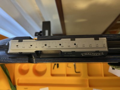

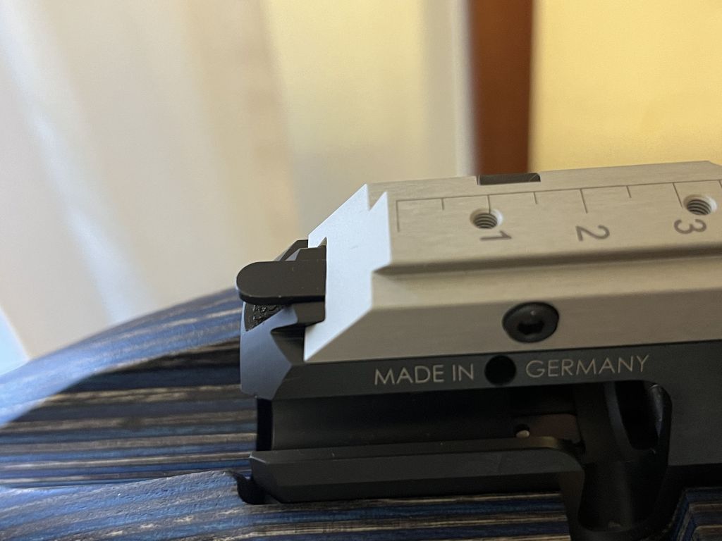

Re: Picatinny rail for KK500?
Hi. This is a old post with no new solution.
I wonder why Walther sells thousands of KK and, in the world, there is no simple rail adapter to Picatinny.
Walther customer support is missing, tried some dovetail adapters with no success.
I have taken some aproximated measures (no caliper expert):
full lenght: 145 mm
upper width 11.55mm
lower width: 9.15 mm
height: 2 mm
angle : 60º
upper screws: 2.89mm diameter. Center spread about 22.5 mm
Gonzav71 sent a picture of his Walther KK500, but seems removed the alluminium upper part than you can see in my KK, and neither could find the piece he mounts at Champion Choice.
I would like to get a simple dovetail to picatinny adapter (20 MOA) to fit on the Walther KK500.
Any help is appreciated.
Thank you!
Carlos
full lenght: 145 mm
upper width 11.55mm
height: 2 mm
angle : 60º
Thank you!
Carlos
