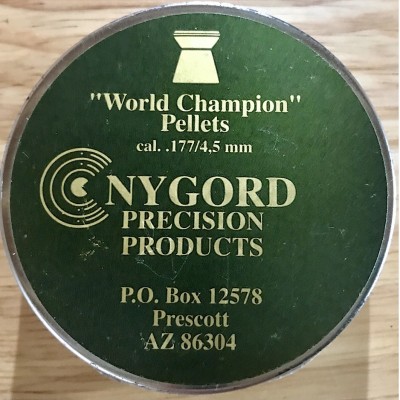

Ok folks, please put me out of my misery quickly, I always thought you were supposed to shoot heavy pellets for rifle and light pellets for pistol. I still have some pellets left from a whole bunch from our old friend Don Nygord. They were good pellets, much better than I deserved to be sure! Don said “here shoot these.” And I did, a whole bunch. For some reason it occurred to me that I never checked to see if they were heavy or light. They say 4.49mm on the tin but do not give the weight either in grains or grams. I don’t have a reloading scale anymore but I do have an electronic laboratory balance that works to the tenth of a gram I use for weighing violin and viola bows ( talk about stuff that costs more than target pistols!) I put ten of my pellets on the pan and divided by ten. I get .53 grams or right on the weight for heavy pellets. Have I been screwing up all these years or am I completely missing the point??
Please help the old and confused!!
Thanks,
Dwight

The Nygords we still have are all heavy...roughly 8.2 grains. We have about 2 tins left. Ours are 4.51.

Since Don himself told me that pellet weight doesn't matter, and H&N (who made Don's pellets) claim they don't package their pellets by weight, but by accuracy, I guess that leaves just me to tell you what to use.
