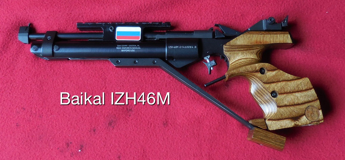

I have a Baikal IZH-46 that I dug out of my safe after not shooting it for 15 years. I am looking for a seal replacement kit for it just to have around should it become necessary, but I am having trouble locating any seals. Does anyone have a lead on seals (particularly a breech seal)? I’m hoping now that Air Venturi is making the AV-46M that those seals will be compatible and more available.

Bump. We have a dead IZH-46M that I am told needs new seals. I see now, in Nov 2023, these are not readily available nor are they inexpensive. I recall someone telling me years ago "there is really just one seal that requires replacement....". I am not experienced nor is the fellow shooter who will likely undertake the project once we know our plan of attack.
Step 1. Lube with Air Tool lube. See if that helps an inactive air pistol.
Step 2. See how we might get some of the seals from Grainger or similar...
Step 3.... Ask for help here in the forum.
Given the shortage or seals and the expense of seals, any wisdom from others out there who have already explored how to service the seals on an 46M? This is a loaner gun for new shooters trying out air pistol.
Thanks!
