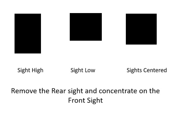

Only one minor change to the sight picture, because your eye likes to see symmetrical things,
make the foresight appear as a square.
Here is a sub 6 o'clock hold sight picture with a square foresight,
1 1/2 to 1 ratio rear sight to foresight and at 70% width of target black.

Posts: 1719
Re: 10m air pistol
Try this, without my rear sight and when my eye wants to see a square.

Not sure I follow David. What are the front sights' heights related to. There must be a rear sight “floor” there somewhere.
Posts: 3573
Re: 10m air pistol
One problem with the square front sight approach is that it requires a fairly deep rear notch. Depending on how "sub" your sub-six hold is, you may find that the bottom of the target is visible in the notch on both sides of the front sight. I ran into this on one pistol a year or two ago, and I found it very distracting.
Posts: 1719
Re: 10m air pistol
With the front sight set up as a square when in the aligned position and the focus is sharp, then you don't really need the rear sight.
If you see a vertical rectangle then the gun is pointing HIGH.
If you see a squashed square the gun is pointing LOW.
If your eye sees a square the sight are in line.
The subconscious will find the square very easy, even with the rear sight blurred.
Helps make the shooting easier.
